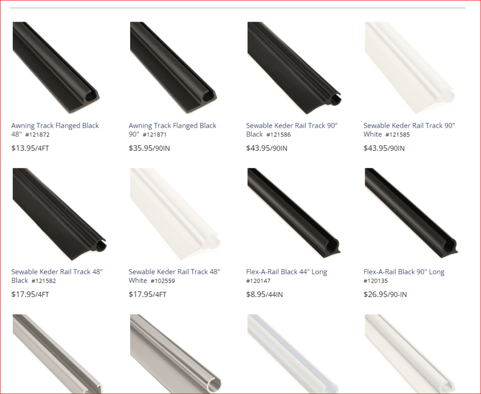

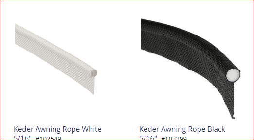

Although I have the aluminum trim in question my boot (came with car years ago) does not have any obvious way of attaching it. I'd love a pic of the "stiff plastic piece". As for your situation perhaps marine flexible Keder rail would work. I was considering sewing on the Keder onto my boot if it would slide into the aluminum extrusion.

yup, tonight after work. We need the opposite things! The female groove is not round. If you are a DIY person, until you find one, perhaps a 1/2 x 1/2 angle aluminum stock could be bent to fit the seat contour. Polish it up and for $10 you have a base to MacGyver an attachment point.
