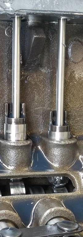

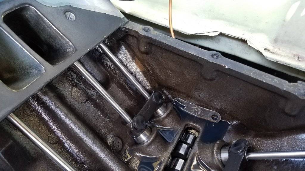

Comp cams hydraulic roller tie bar let go while cruising down the highway at 55 mph. I let off the gas and heard a little ticking. The tie bar pins failed letting the lifters rotate in the bores. As you can guess it ruined the cam and put metal everywhere. I called comp and they told me tough luck, 1 year warranty. I estimate i have about 6500 miles total on this cam/motor combo. I expected these to last basically forever.
512 Stroker
Comp retro-fit hydraulic roller XR280HR and their lifters and springs.
75 psi oil pressure
Valvoline VR1 20w50 oil

Assuming that the tie bar components did not get mismatched some how, it would appear that the tie bar pin(s) were improperly tempered at the factory. This would be a clear case of defects in materials and manufacturing. As you are out of warranty, that does not help much unless you can get them to make a policy adjustment. Send them pictures of the damage and tell them you are going to put the same photos on every performance website you can find. An obvious failure like this one should scare the hell out of them.

In the mean time, take everything apart, retrieve ALL related loose items found in the engine/oil pan, document with pictures (cam/lifters, other lifters/tie bars, engine bearings, cam lobes, etc.), bag it all up for future reference, get the engine cleaned up and ready for rebuild.
As that particular system of roller lifter alignment has been used for over 50 years, there should be no failures of tie bars and such at this time. The original uses were in pure drag racing engines, with much intense valve timing events than any "street-driven" car might even have, by observation. But, of less run time exposure. If anything was suspect, it should have been exposes well before now. Or fixed! No cam company desires to have a drag racer lose an engine in a final round due to component failure. Such a failure would have resulted in the loss of many $$$$$ to the racer, possible related future business, and word-of-mouth negativity in places the cam company didn't desire it to be, IF blame could be placed on the cam company for the loss of the race. Be that as it may.

Suck it up and fix it. We have all been there. Tie bars are a crappy design and why you do not see them on OEM. The spider and dog bones look even worse but they do not have the moving parts so they won. The best way for longevity is keyed lifters but good luck financing that.
