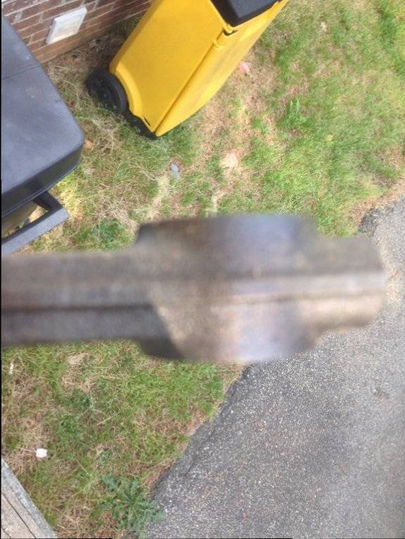

I bought the smallblock Magnum 5.9 rods off the net. They are supposed to be resized on both ends. However when I got them they have the heat marks at the small end. Looks like they where heated with a torch to help push the pins out. So do you guys think these rods where damaged. Plan to use them in my new race motor & spin to 6000-6500.
I think they're OK. I've heated rods to assemble them for years. An engine builder I know, whose engines have set some Bonneville records, showed me how to do it. It eliminates any chance of galling the pin as it presses through the rod and then slides into the piston. A galled pin will tear up a piston.
In a perfect world, they shouldn't be heated more than 400F with an electric rod heater and should not have any discoloration (the blue) but it happens if someone is doing it with a torch. If the whole end of the rod was blue, I'd be concerned.

I think Goodsen has a rod heater that's propane fired and that would blue the end like that

They're not usually heated to get the pins off - only to get them back in. That one doesn;t look too bad honestly. Howevefr, you might want to consider a set of 273 rods. They are lighter, plenty strong, and have the bushings to run them full floating. Just a thought...
