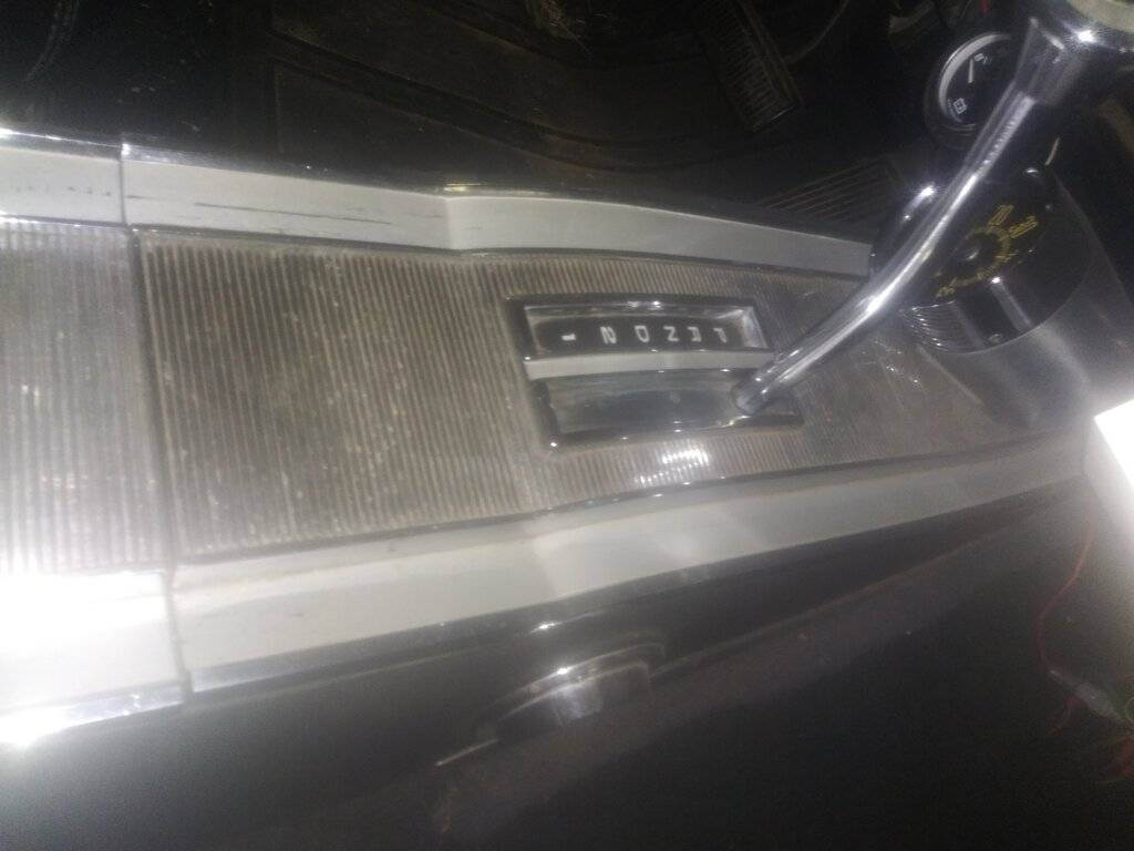

What is the proper shade of silver to duplicate what is in the inch-wide area that borders the entirety of a '66-'67 console (and most later through '70)???

I'm talking about the silver strip around the top perimeter of the metal top. Alreadyady have paint for the console body.

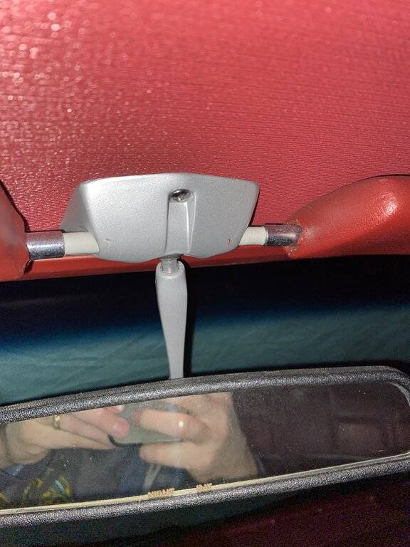

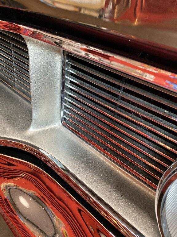

It looks like the light argent silver that is used on the mirror and grill.
