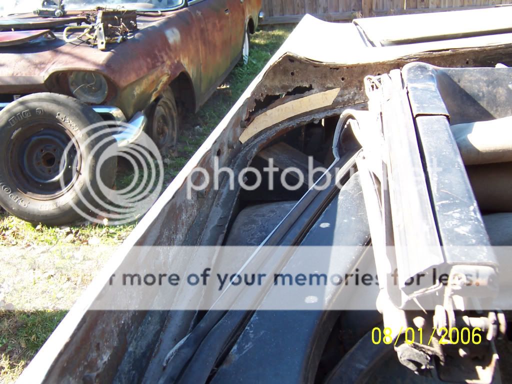

Unfortunately it is a common problem, and I've seen it on every vert I've owned. Behind the rear seat, under the well liner, just below where the top bolts on is a drip rail that rusts through. Here are a couple of pictures of the problem on my 300:
I've been toying with the idea of gluing in half a PVC pipe to replace the drip rail, but haven't experimented yet. Good luck.
