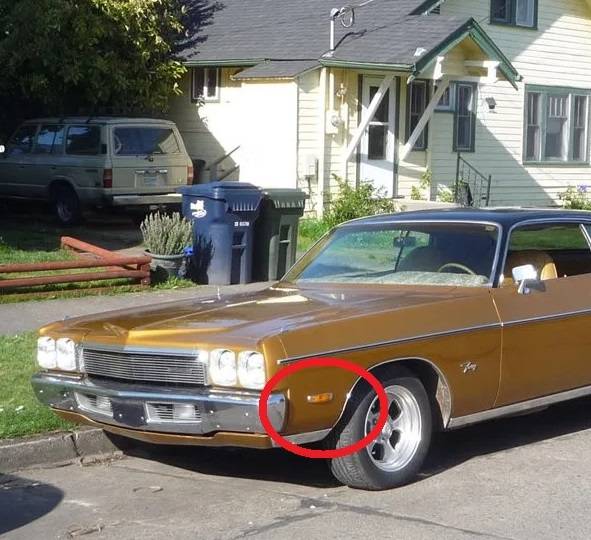

Are ypu referring to the all orange marker on the fender, or the clear turning lamp option. If it looks like the one in this pic, it should always be illuminated with the headlights on.
