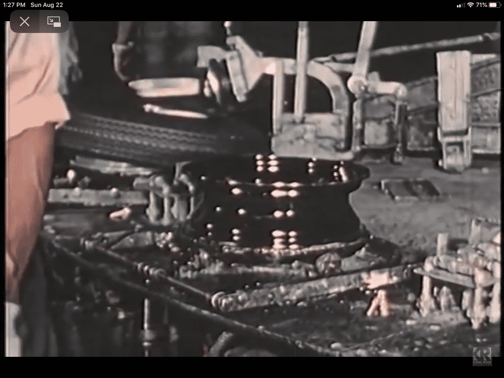

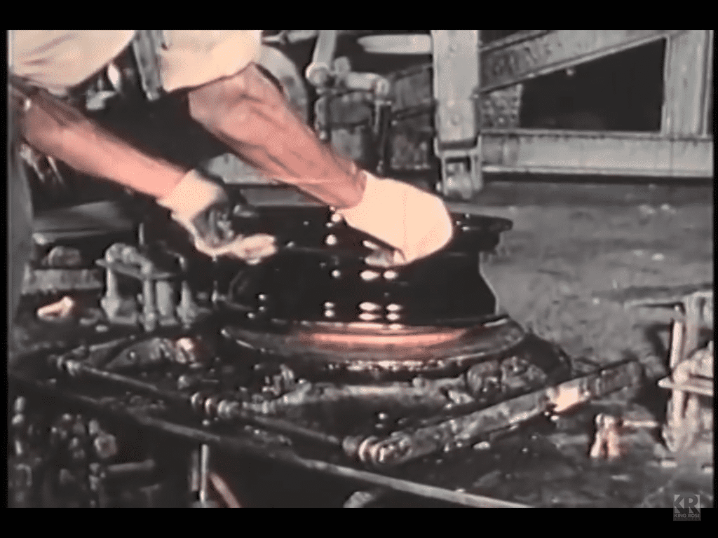

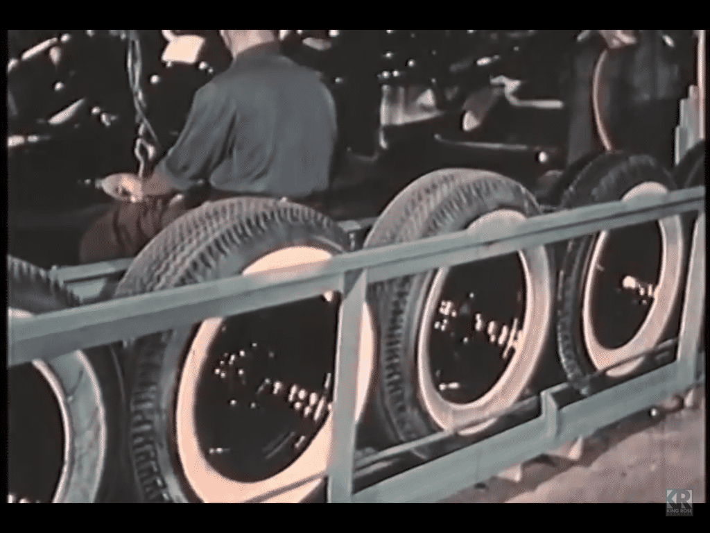

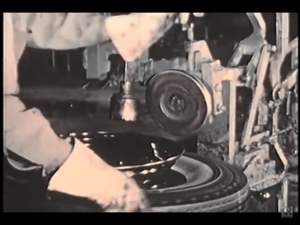

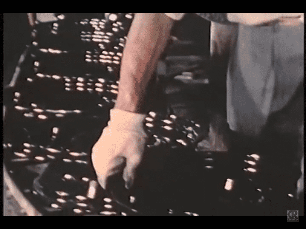

here are phots from the factory.
GLOSS black. If you get a look and a clean original wheel they were gloss. They get scuffed from wiping and washing and they look satin. Then you take the tire off and they shine like a diamond inside the rim where it’s been covered it’s whole life.
That's what I seem to remember but everyone says satin. At one point the wheels on my car were painted flat black. Thank you.
I'm going to say its a gloss finish. The paint used was exactly high quality, and most likely, applied by dipping the wheel.
It aged fast and got a little dull, but there is no doubt that they started out gloss finish. I bought some new wheels from my local dealer in the 70's and they were glossy.
I wouldn't paint them with base coat/clear coat and make them a high gloss, but a gloss enamel like Rustoleum would come pretty close to OE.
They might well have been "gloss" rather than satin or flat, BUT they were not a hard gloss black as the exterior paint might have been. Whereas the body color wheels would have been the same paint the car body was painted in, being a hard gloss acrylic enamel finish.
