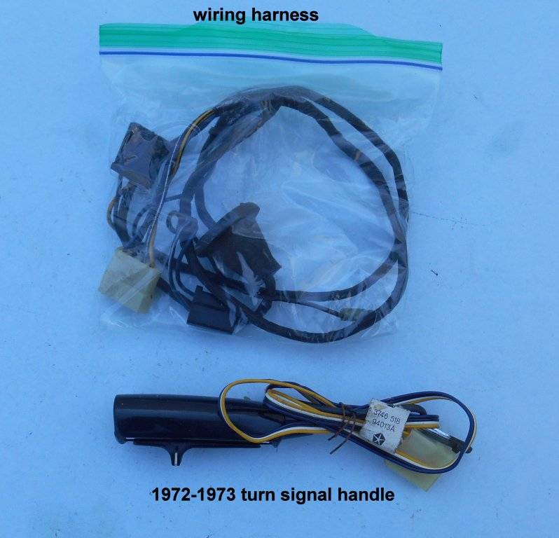

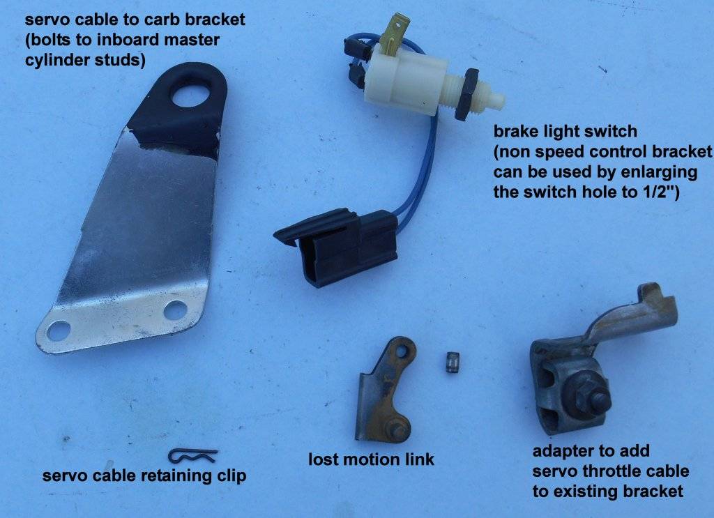

There is a difference between the E body stalk and the b and c body stalks. One difference can be how it mounts to the steering column. Another is the angles coming off the steering column mount are different. Also, the length of the stalks. The E body stalk is longer. The attached photos you can see the differences a little better. There is a slight angle difference, and the E body lever is about 1.5 inches longer than the B body.
