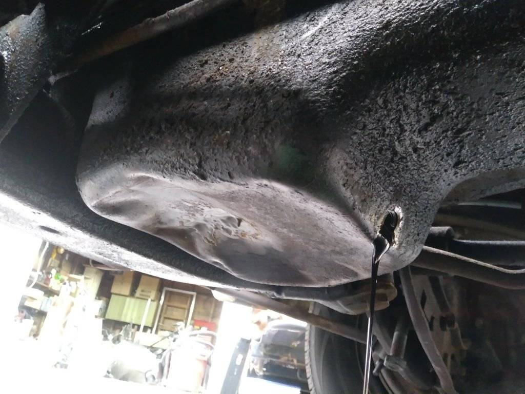

The previous owner pushed a jack up through the bottom of the oil pan in my 67 newport 383. They JB welded the hole shut and it doesnt leak, but I am pulling the engine for other work as well...so do I hammer it out and weld up the hole (I am a fabricator/welder) or should I order a new/used pan? If replacing it....which one do I need? Im assuming I might need to replace the oil pickup as well...its pushed in about 1".

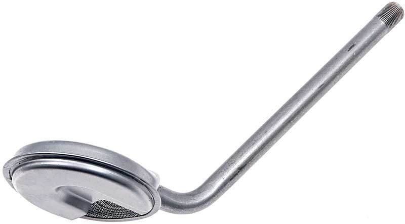

187 2532186 1967-1972 C 383 400 440 Strainer 2532264 is what info i can find, but this doesnt tell me much for aftermarket suppliers
Mopar had different pans for different style bodies. It should be stamped on the pan, 3 digits. I'm sure your pan will be body style specific. Good Luck
Stock, nothing special 383? If the pan is in overall good condition, beat it back into shape and weld it up after you clean out all traces of the JB Weld.
Make sure the pickup didn't get bent and be sure to check the pickup to bottom of the pan clearance.
Kevin
any idea what the clearance is supposed to be?

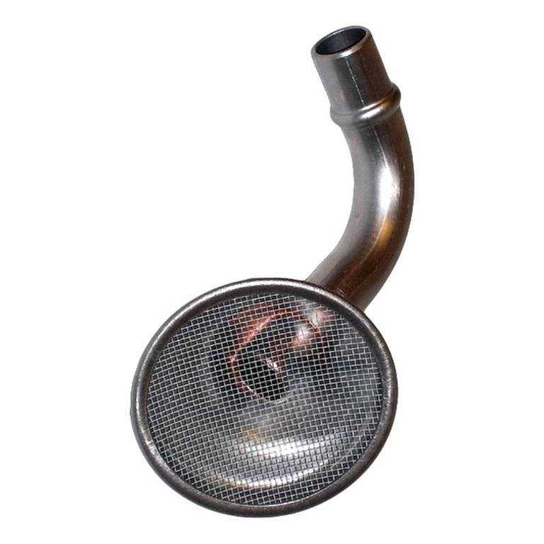

With a stock Mopar pickup, the pickup should touch the bottom of the pan. Emphasis on the word "stock".
An aftermarket pickup with the strainer screen on the bottom needs a 1/4-3/8" clearance.

Yep, that's bent, but looks to be worth fixing. Also, if I was you I'd take the time to clean and degrease under there before you pull that pan. But I just like my stuff to be clean.

Looks more like someone used the pan for a place to place the floor jack a few times. If anything, once it's out you could probably take a 2x4 or similar and pound most of that out. The only thing is if it's tweaked the wrong way it may leak at the plug. Good Luck
Some of those bend radii look a little small, so getting them all round and smooth again might require some real body work (hammer and dolly stuff). A good used one might be a quicker option? With a matching pickup tube?
One thing about it, with that concave section of the pan's sump area, when you drain the oil, no residual hanging around in the bottom of the pan.
