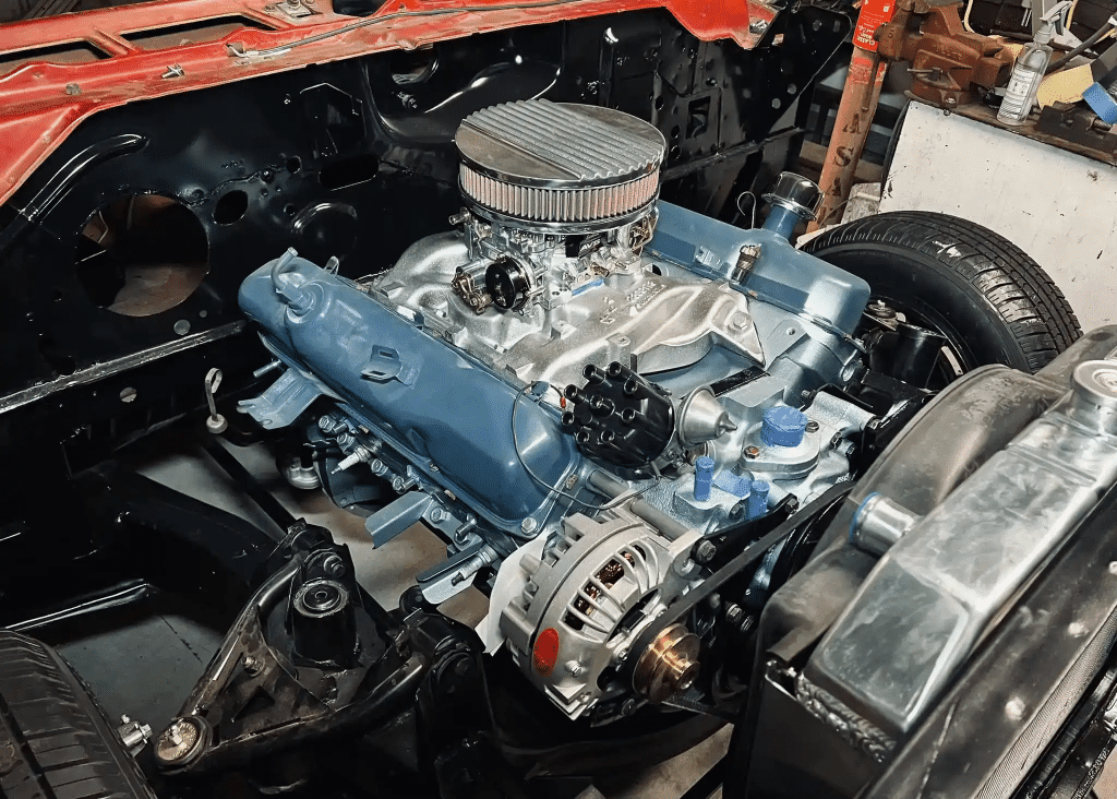

I'm sure most of you are familiar with me and my backstory as well as the car I've been fixing up for about 2.5 years! At this point, I feel like I'm "spinning my tires" in the mud. This car has been an enormous challenge and a lot of time, money and effort to get to where it is today. So now we have the motor, trans and everything else in there ready for an initial start. Only, I've NEVER done that. I don't know exactly what to do, and don't quite trust myself to set it off. I spent good $$$ on the rebuild of my motor and trans, and I'd very much like to keep it safe and not mess anything up!
Unfortunately too, my circumstances do not allow me to keep this car. So when it's done, it will be for sale. It saddens me very much that I will have to say goodbye to my old girl, but I hope it goes to another fellow C Body enthusiast who will enjoy her and give her love for many years to come. I only wish it could have been me!
Life has been a little crazy, family death and short staff at work have my hands tied. Unfortunately this has put the car on the back burner. I am trying to get back on it, and with urgency, as it can't sit around forever. I would like to have this car on the road or at least close to it by the end of the year. Not far away, but it essentially just needs to be put together.
For now, I'm trying to see if there's anyone local to me, willing to be able to help out or guide me through an initial start / break in for this 440 engine. It was rebuilt early 2021 and has not been fired once since the rebuild. I've never heard this car run, never driven it, never enjoyed it in all of my time owning it. I would like to at least drive it around for a little bit before she leaves my possession, that way too - I can be positive she is a solid car, and will be reliable for the lucky person who gets to keep her. I appreciate any help and advice as always!

Thank you everyone!! I am very thankful for everyone's tech and tips here. I should have mentioned from the get go, that I do indeed have the priming rod / tool (Mopar branded too, do I get bonus points?!) I will be running Lucas SAE 30 Break In oil also. Plenty of dinosaurs to keep my flat tappet cam happy! After the fact, I'd planned to run Valvoline VR1 10w30...
I've done plenty of research and know what goes into it, but like some have stated - I'm afraid I just might miss something that could mean life or death for this engine. Luckily, I was able to get in contact with the engine builder. He's a well respected dude from Guadalupe and is the president of a lowrider Car Club called Touch of Style. In fact, he has one of the cleanest Cadillacs around! Although he's a lowrider guy, his dad is a local racing legend - and he grew up with a huge love for racing and performance. He does great work and I know a couple guys who've had their motors rebuilt by him, all happily chugging along years after the fact. Guess I rambled on, but long story short - he said he'll stop by and help me get it going!
Tools I have on deck are a oil pressure gauge, vacuum gauge, temp gauge and timing light. Was looking to buy a trigger to crank the starter while working in the engine bay, also too - there's not dash in the car so that's pretty much the only way to crank it without busting out the screwdriver... I have the starter relay mocked up on the core support for now, and will wire up the starter and battery and make sure we have good power.
