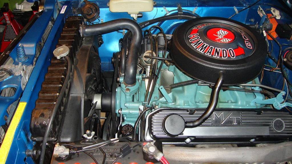

Here's a couple of pics of my 68 GTX for ya, Scott.
My plug wires are Chrysler date-coded wires. I cant remember for the life of me wth I got them though. And fyi, the one on the pass side, furthest back goes on top of the valve cover and over the back of the motor.
On this one some one has the rear cylinders on both sides routed over the top of the valve covers and the others come down the front of the cylinder heads. Is this correct? The wire on the car are good right now but it has other driveabilty concerns and he wanted them changed. I am going to forget about them for now and concentrate on the carb and ignition.

IIRC, on the driver's side all 4 go down the front. I have not fiddled with the mechanical advance. I would have to look at my notes to confirm, but I think mine was 14-16 initial.
I believe this is how my wires are routed.
