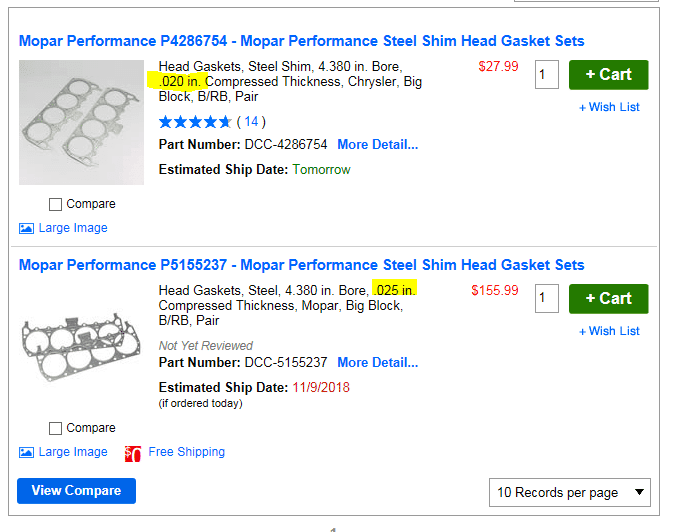

I didn't think the steel gaskets were available anymore, and had no luck on Jim's site.
Was wondering about this recently as I have a POS used 440 I'm midway thru evaluating to see if it's worthwhile.
Had a stuck valve, so took heads off, found 1 steelshim gasket and 1 blue one, so somebody's been in it before.
But a Goog found this for me!
CHRYSLER 7.2L/440 Mopar Performance Steel Shim Head Gasket Sets
Used to be that the steel shim gaskets were spec'd at .020" compressed thickness and the composite gaskets were .040" compressed thickness. Some of the normal aftermarket composition gaskets are up to .060" compressed thickness, so look for the thinner ones.

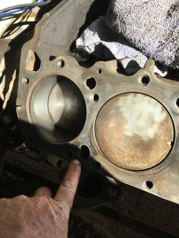

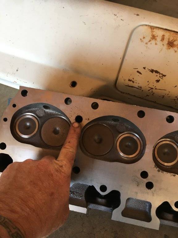

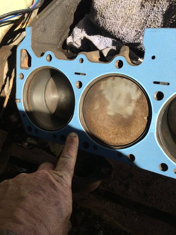

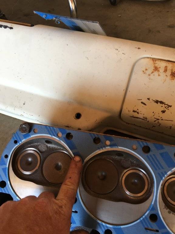

I'm a little late, but this may be helpful to someone.
Pic from the '74 440 motorhome engine I mentioned earlier.
The steel and blue headgaskets that were in it are pictured.
I didn't capture them with 'top', but the features of interest here can be seen across several cylinders (and they look symmetrical anyway).
I do not know if the steel one is original, but the blue surely is not. Very few of the headbolts had that nice 'pop' when breaking them loose, so perhaps the steel one is not original either. Either way, some amateur, or some cost-cutter, was in there to mix gaskets like that.
Thanks Davea and Cbody67 for the info about the slits for the upper passages. I might've wondered if the MH would've benefitted from enlarged holes, and might've been tempted to tweak the gaskets.
So correct me if I'm wrong:
The green are the spots for coolant passages, the upper are slits, the lower ones are blocked (blue X) by the gasket.
What is the coolant path, then? Seems like it must enter the block from the water housing, flood around the cylinders, up thru the 3 slits, thru the heads outward toward the exh manifold, and return to the water housing via the largest openings at the ends of the heads?
