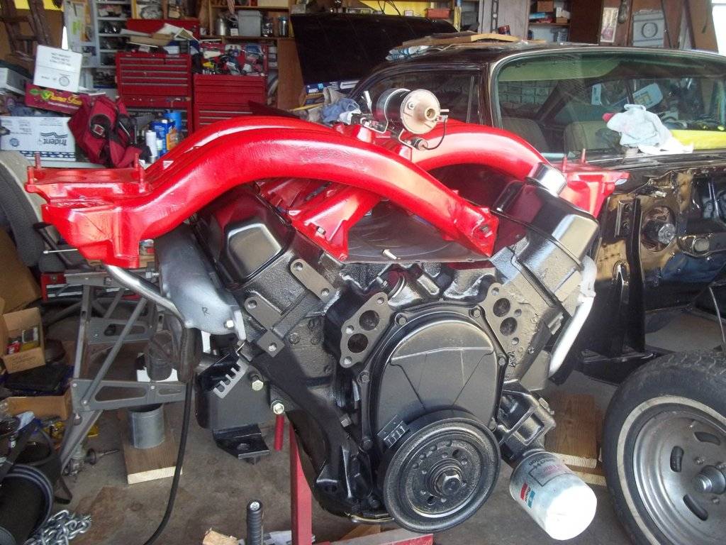

That's my Red 1962 300 Sport Convertible with the 413 with the problem.

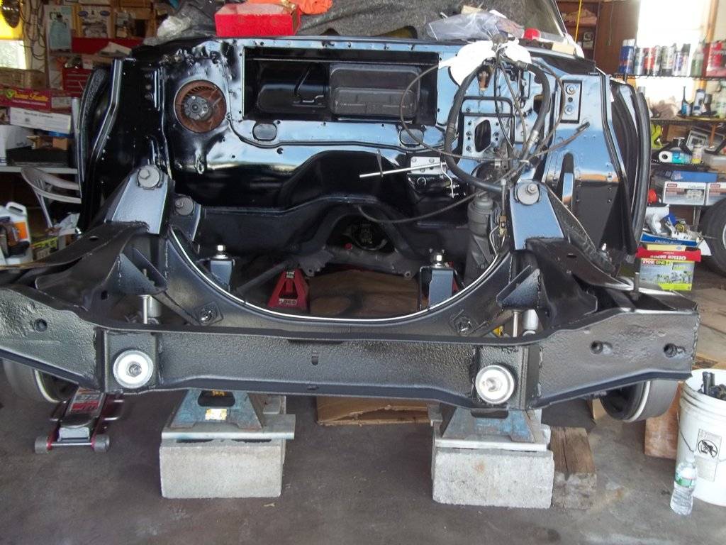

I am restoring my Black 1961 300G. Soon ready to install the engine and transmission but that will be on hold until I get the other problem corrected.
