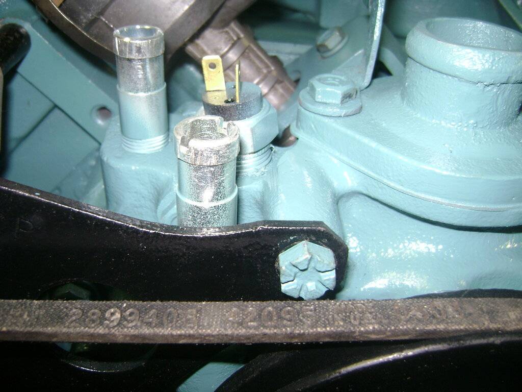

Have a 68' 300 i am rebuilding. Have redone some electrical from a bit of a hack job from previous owner. Not at the stage of starting yet but am putting power to the switch to test electrical as I move from dash to engine compartment. Engine bay is finished however not sure what is supposed to light when turn key right to "run"position. I only have the oil light illuminating. I would have thought the "cold" and maybe others should light up. What lamps are supposed to light prior to starting in "run" position?

On 68 models,common areas to check are; temp sending unit and plug going to it.
The two prongs are hot and cold.

I have tested the temp sender as per manual and all is good there. I turned my attention to the two violet wires coming from the the rear of the ignition switch. According to the service manual, the violet wires, which are connected to "GRD" terminal on the switch. Is there not supposed be power to that terminal with the key in "run" position to power the temp sender? The "accessory" terminal has the black 12ga attached and that gets power with the key in "run" position. I cannot see a part number and am wondering I have the wrong switch however looking at Rock Auto site, the terminals are the same as what I have.

At the sender,the engine is ground. At the cluster,the dash frame is ground.

Was a bad temp sensor. I must have misread the device manual. I heated the sensor and the “cold” cam on until it cooled. Purchased a new one and all golden.
