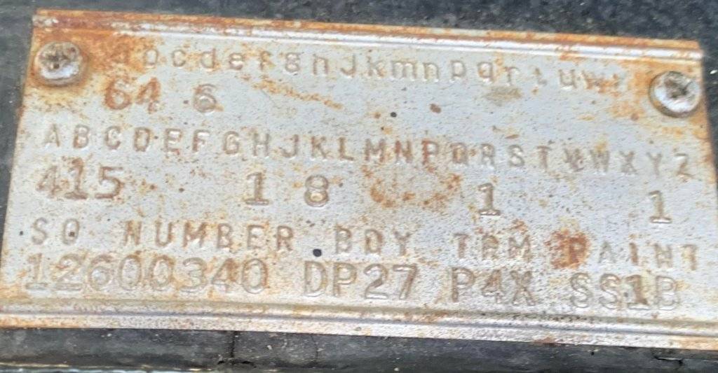

So had an intresting car land in my lap, but when reading the data plate they provided, the designations are really weird. The trim is for a Coronet. The model doesn't exist, WEird things like that. I'm chalking it up to be a Canadian Monaco model, and wondered if anyone had any data for helping to decode Canadian data plates?
For reference the car is a 66 Dodge Monaco Convertible.
Sure thing. The BDY doesn't match anything, but the 27 fits all convertibles. The trim matches the coronet black designation. I have no idea what SS1B means

Looks like a standard tag to me.
Should have a 6 at the top right if it's built for canada
Do you have a source for that data? I ask as from that the car's got the wrong colour, and the wrong drive train. Which wouldn't surprise me (the amount of cars with the wrong drive train is crazy on the market)

The tag is the source. 415 = 318 auto
DP27 - self explanatory.

A pic of the serial # would be good.
And in the pass side door jamb does it say made in canada

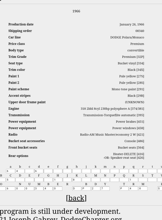

SO NUMBER - 126 - January 26, 1966 - 00340 - Shipping order number
DP - Monaco 500
27 - Convertible (technically 2 is two door, 7 is convertible)
P4X - Interior - Premium/Bucket/Black
SS1 - Pale Yellow Roof/Pale Yellow Body/ 291-Mono Tone Paint
B - 31B - Accent Stripe - Black
AB-41 - 318-2
C-5 - 395 - Automatic Transmission
H-1 - 451 - Power Brakes
K-8 - 458 - Power Windows
R-1 - 421 - AM Radio
Y-1 - 301 - Black Top
a-6 - 486 - Console
b-4 - 654 - Bucket Seats
d-6 - 426 - Rear Seat Speaker

So found the VIN and looks like once again, the drivetrain doesn't match what is in there if the online decoders are correct.
DP27E09252717 - The model and body type come out right, but the E is a 361 or 318 depending on the translator. Could be an F, that some say is a 383, but others say is a 340. I have no idea what the 0 is. Maybe a badly transcripted six?
