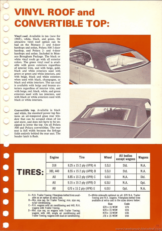

From The 1970 Hamtramck Registry - 1969 Dodge Dealership Data Book - Monaco & Polara
You'll see that 15" wheels were standard.

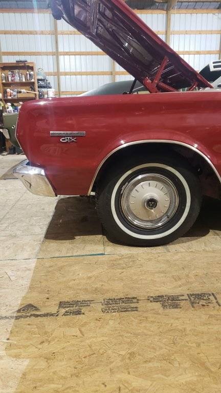

I went to the 68 C body 15x6 rims,which were standard when equipped with disc brakes. I could not locate any 15 inch rallyes anywhere.When equipped with 14inch,( my 66-68) they were 14x6.
Is yours the Steelies with hubcaps? Any pics? Thx

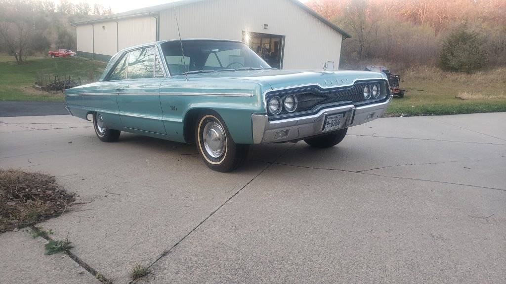

I can get one tomorrow. on the Coronet I blasted and painted the 15x6 wheels to the color of the car, then Used a nice set of 68-69 dog dish caps. on my 66 Polara , I Installed 15x6 wheels and Installed 1969-71 chrysler full caps, which I think fit the style reallly well.
here you go. The Gtx with the 215/75x14 sits taller than the picture suggests.The polara has 225/75x15 Toyo Tires mounted.
I don't have a picture yet of the 15x6 painted with dog dish caps available.
