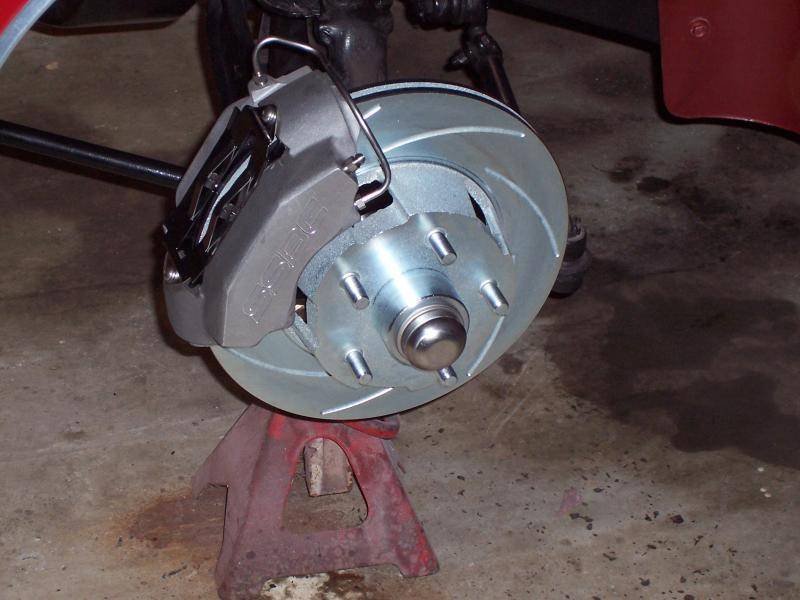

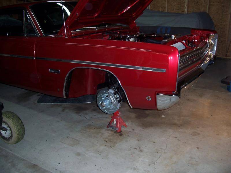

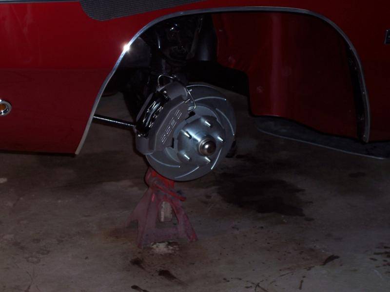

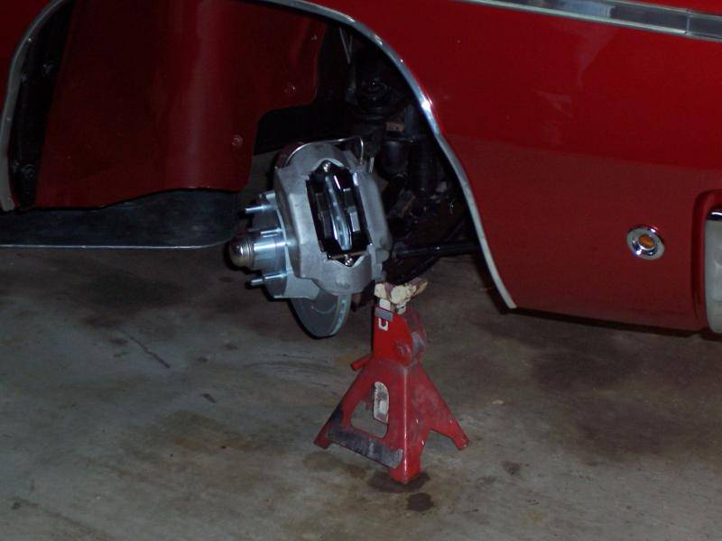

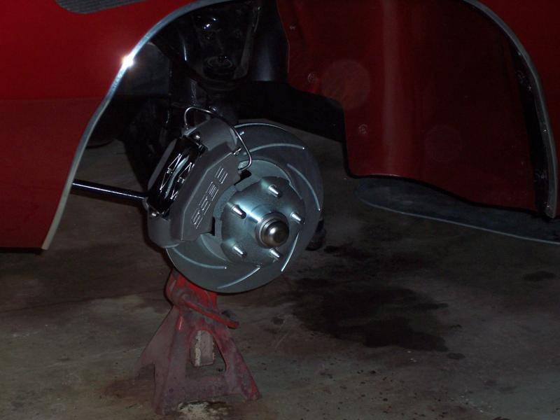

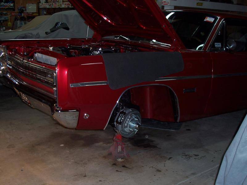

I used the ssbc system wasn't cheap but really made a big difference. Joe 100_2376.jpg100_2377.jpg100_2378.jpg100_2381.jpg100_2382.jpg100_2383.jpg

Joe: what was involved in making the change.did you have to change the master cyclinder. what was included in the kit. have been thinking of changing my 68 sport suburban wagon over to front disc.
Everything you will need will be in the kit including the master cylinder. I bought the A154-4 http://www.summitracing.com/parts/ssb-a154/overview/make/plymouth/model/fury-iii http://www.summitracing.com/parts/ssb-a154-1/overview/ http://www.summitracing.com/parts/ssb-a154-4/overview/
