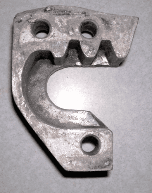

Once I got it removed and cleaned up though, I did see marks indicating that the latch was binding on the forward lip of the striker, so I dug up another shim and added that to the original to move it a bit further out from the door post and towards the latch. Thankfully, the local parts store knew exactly what the FSM was calling for......
Once the striker was re-installed with an extra shim and lubed up, I proceeded to adjust it a wee bit and was happy it only took me 4 tries to get the door to operate nice and smooth. Especially since I'd tried about 20 times before I started looking for the proper lube and actually fully removing it where I was able to determine the problem. I believe it was set a bit too tight from the factory and had been an issue for the previous owners for years, based on the oil/dirt residue on the door and post.
