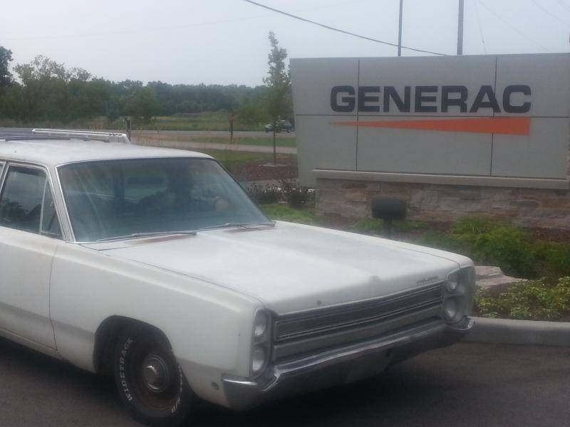

I lurk here alot but I now have a problem I could use some assistance with. My car is a 1968 Sport Suburban (Fury wagon) with 4 wheel power drum brakes. The brakes would not function properly so I replaced: brake booster, master cylinder, wheel cylinders, and brakes shoes. My issue is with the master cylinder adjustment rod (I think anyway). Following the advice of smart people I adjusted it so the M/C was about 1/16 to 1/8" from the booster. I found the brake pedal to be very low so I made the rod quite a bit longer and the pedal was much higher and the brakes worked like I though they should. I used it for local errand running and such and all was AOK.
I brought it to work today and about 2/3s of the way here the brakes started dragging pretty badly. Since I have this thing about not missing work I drove through them and smoked the new shoes but I got to work needing two feet to stop it. A tech let me use some of his tools and at luch I adjusted the push rod about 2 - 2 1/2 turns shorter. A quick test drive showed the brakes working, amazing I know, but with a low pedal again.
I am reasonably certain the brakes were bled completely so that should not be an issue. What is puzzling me is why did it change.
