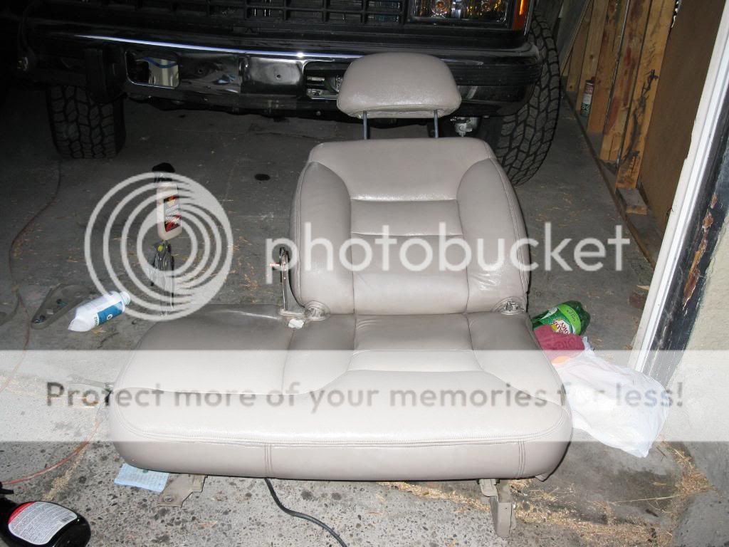

Good advise. You can not get the work surface too clean! I have found that the finish comes out much nicer and with more of a factory look if you use the SEM Semi Gloss clear as a final coat.

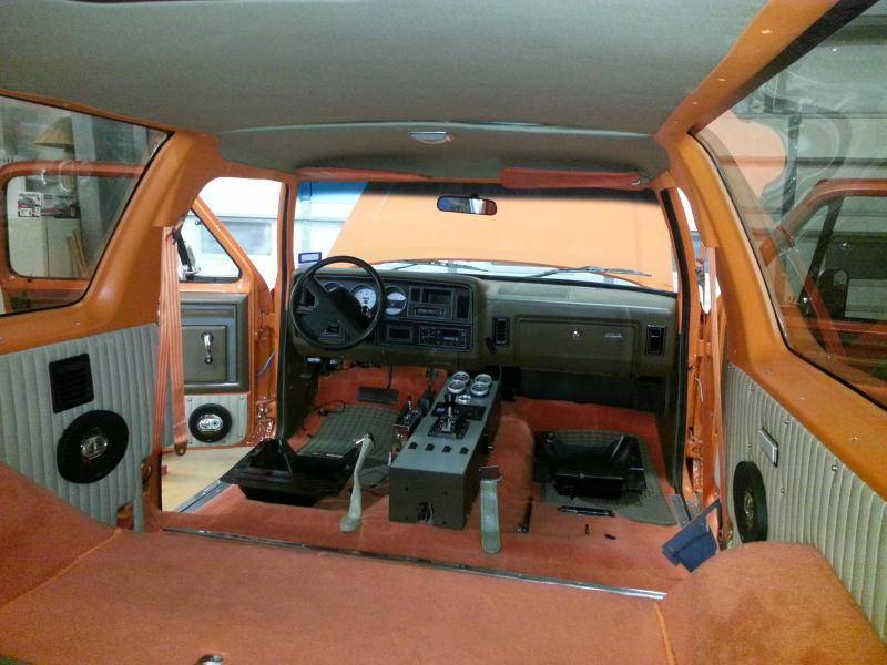

The interior of this truck was all navy blue before we dyed it.

Either way..... I have found that it is better to see the color selection in person to get the best match but the auto parts stores generally have a limited selection. If you can get someone to send you the color chart then you can order it on line for less. Also one of the better automotive paint jobbers in your area should have a color chart. Email SEM for auto paint stores in your area, not just parts stores. I can not stress enough that the semi gloss clear coat is what makes the best look, feel and finish. Some of the first pieces I dyed just did not look right and I had a upholstery shop tell me to use the clear coat and it made all the difference.
The tufting and the buttons that are recessed can require multiple cleanings to get the surface really clean, especially if you or a PO have used ArmorAll or a similar product. I have had good luck cleaning using a small hand held steamer being careful not to get the vinyl too hot. You will be amazed at the dirt and crud that will come out. Also a warning, do not use paper towels for the last cleaning, as they will leave fibers on the surface that do not show up until you start spraying the dye....ask me how I know. Use well washed old terry cloth towels and finish with a treated tack cloth you can get at any home improvement store. I think you will be pleased with the results. Good luck!

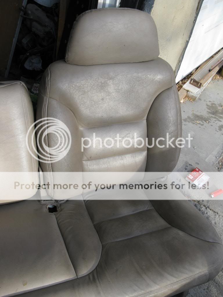

Those seat look like leather, if they are you better get the right dye if you use SEM. If you use a lacquer based dye on leather, YOU WILL have problems. You need a water borne dye for leather, regardless of what anybody says otherwise.
