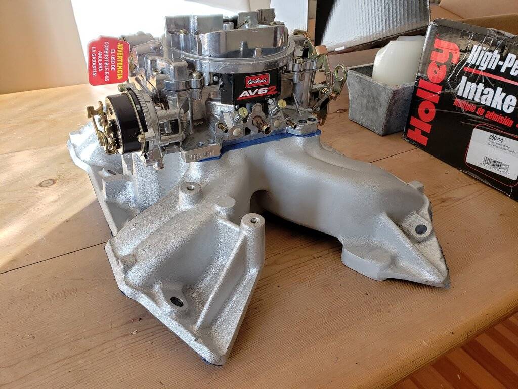

I went with after much deliberation on my engine build which includes being able to use my stock dual snorkel air cleaner ,to a Holley street Dominator single plane intake on my 505 build topped off with a Edelbrock 800 cfm avs2. I had also gone to FBBO as my engine designer frequents there and between all the hoopla we all seemed to agree the Dominator even though a single plane would be best. I will say my engine designer said in a perfect world he would prefer the RPM. But because of my hood limitation he would bless the Dominator. In my situation,tune he said the difference would be minimal. Edelbrock states the RPM dual plane is 1.75 inches higher than stock. Here is a pick of the single plane street Dominator with web removed. I will paint it all turquoise. From what I have read all stock bosses are there like a stock intake.

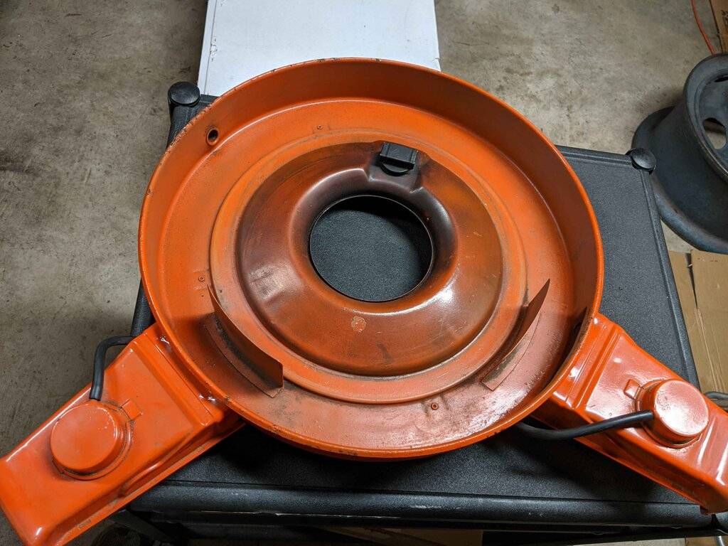

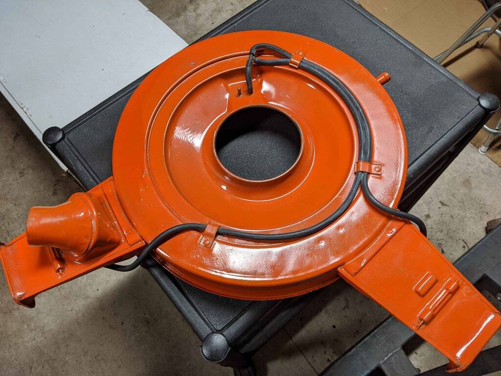

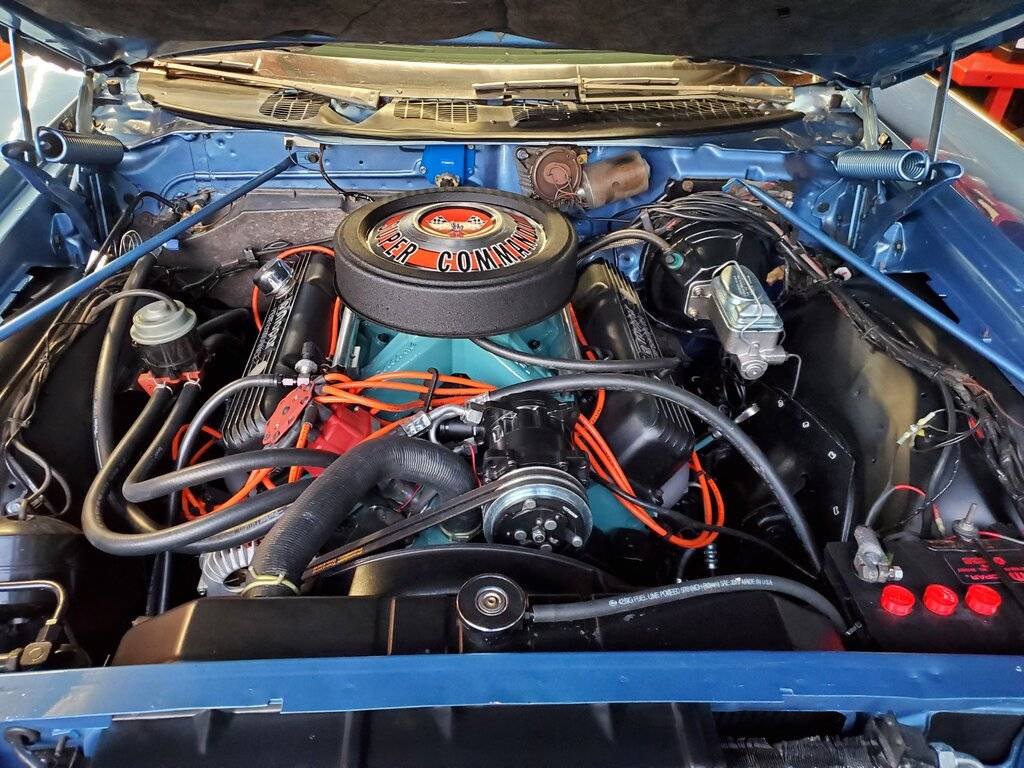

1970 Pictures for reference. I can't even find a welded seam. It seems 1-piece.

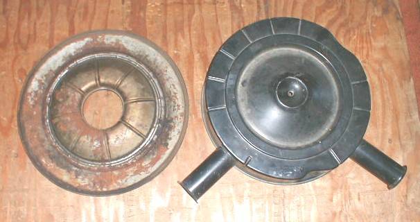

Your air cleaner won't work with the drop base. Earlier dual snorkel air cleaners have the snorkels on top that can be removed from the base or just the opposite as yours. I hope someone chimes in with a pic of the earlier style air cleaners to show you. I will have a look and see if I have one.
Not mine but something like this. Furygt has a very clever way to make it work . The Mancini lowered baseplate is about the size of the inner circle of the pictured base plate. It is big enough to support the stock air filter. It actually opens up a lot more area for incoming air and looks stock. I am not sure I need one yet. I may do it anyway.

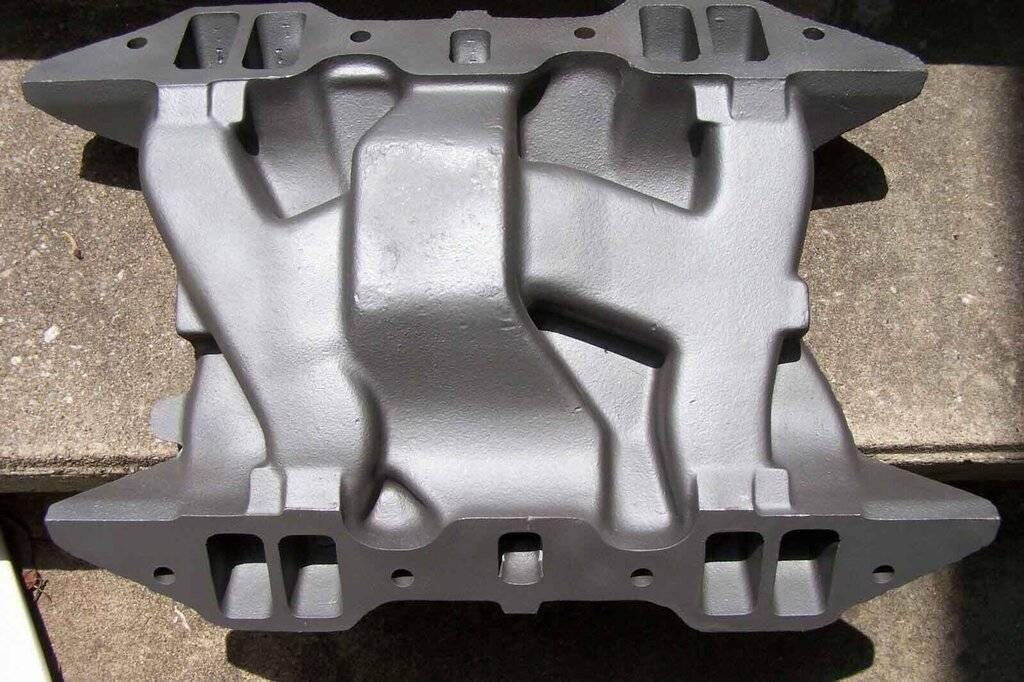

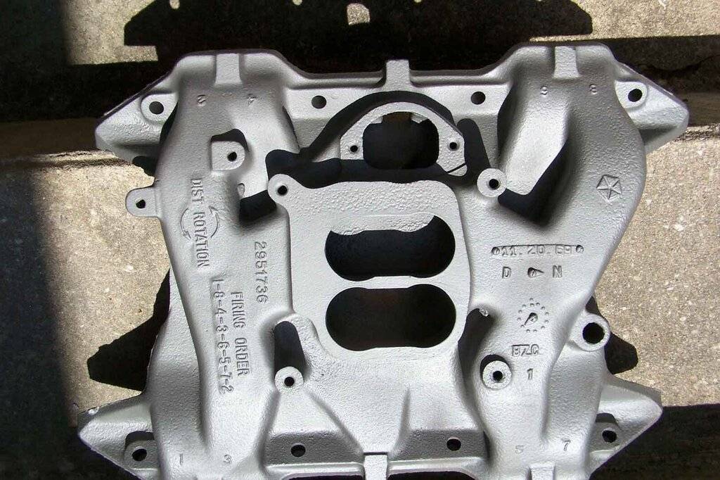

Edelbrock 2191
Dislikes
  • Spreadbore configuration
  • Thin carb mounting surface
  • Ugly EGR mount that needs to be plugged, although plugs come with intake
Factory: LOVE the 1970 factory look, cast# 2951736
  • Dual Snorkel will sit at factory height
  • Date matching
  • Sides have less than .04" warp: arrow straight
  • Bead Blasted
  • Heavy, but who cares?
  • FABO: guys says factory flows better up to 3200 rpm, Hmmmm. Not bad on street car.
  • Dave, Davealux says I will loose 10 HP, but that's top end on a street car.
  • $220 shipped from Parkville MD
  • Just too tempting not to give it a shot!
