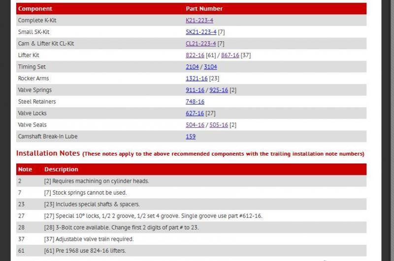

If you use the later intake, any Edelbrock carb will bolt up. The earlier one uses a narrower patter that even the Edelbrocks won't fit. Avoid the adaptor if you can.
On the cam - great choice. Comp makes great products. Another economical choice would be the Summit Racing branded "small" cam. It's smaller than the Comp XE268 but makes great power. It's also a bit cheaoer. Buy a set of MP springs and run it. I like a 600-700 carb for a 383, especially a milder one. So the 650 Thunder AVS would be my first choice.
