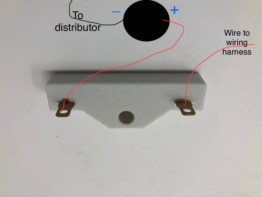

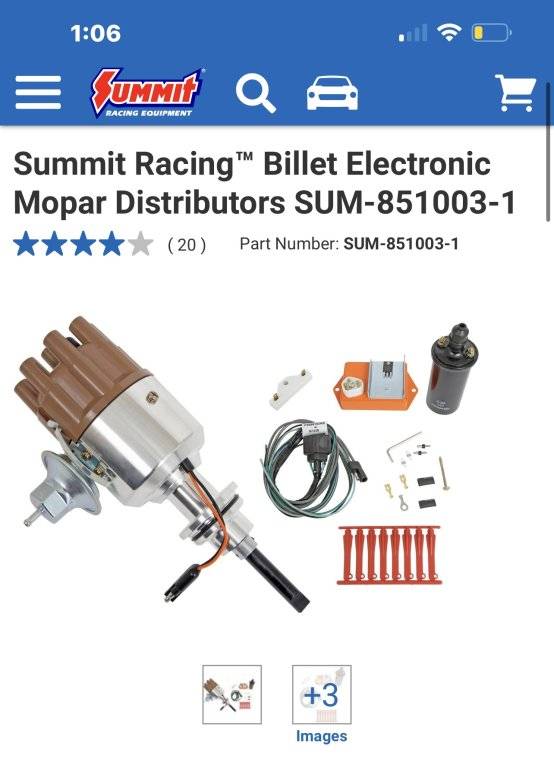

I’m doing a electronic distributor conversion on a 1965 Chrysler New Yorker and wanted to see if anyone has and pictures on how it’s wired
