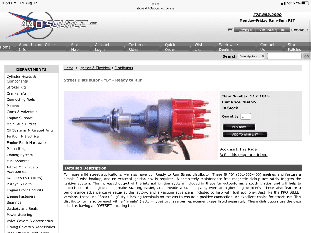

Electrical issues , I recently had a post about no spark with my 383, I thought I found the problem? I have a proform distributor and orange box setup it ran pretty well till it quit completely I replaced the orange box and it fired right up it seemed to run good but after a few minutes it dies ? I am thinking about replacing the whole works with a billet type from 440 source . I will post a photo of the one I am looking at. Just wondering what your thoughts were ?
Have you tried a different coil? A shorted coil will work fine when it is cold and then short out when it warms up. The pickup module on the distributor will sometimes do the same thing. You can test the module with a test light, hook the test light to a power source and hook the ground lead for the test light to the wire coming out of the distributor to the coil. As you crank the engine, the test light should blink on and off if the module is working. You would want to perform this test after the engine has quit. Mopar orange box units need a clean ground to operate properly so be sure to check your ground. The billet distributor you have in the photo generally uses a GM type module with GM type plug wires so you would need to buy a set of aftermarket wires in addition to the basic distributor. That will set you back another $60 unless you specify a female type cap which is usually sold seperately. The other work of caution is that you would want to be sure the distributor does not have a chicom knockoff module inside as those are a POS.
