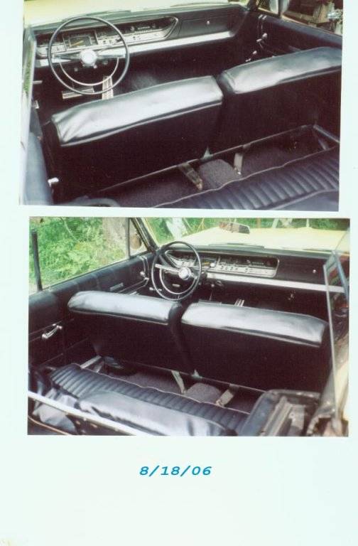

It was a super hot day 95 degrees + and I was welding a small piece underneath on the frame and the rear carpet caught fire. My convertible top was 1 week old and ruined of course. I was careless and paid dearly for it. The attached pic is how she is today.
John

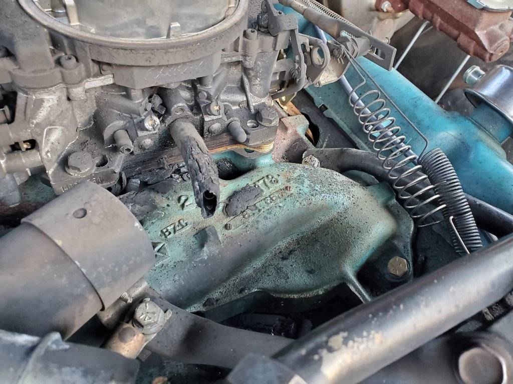

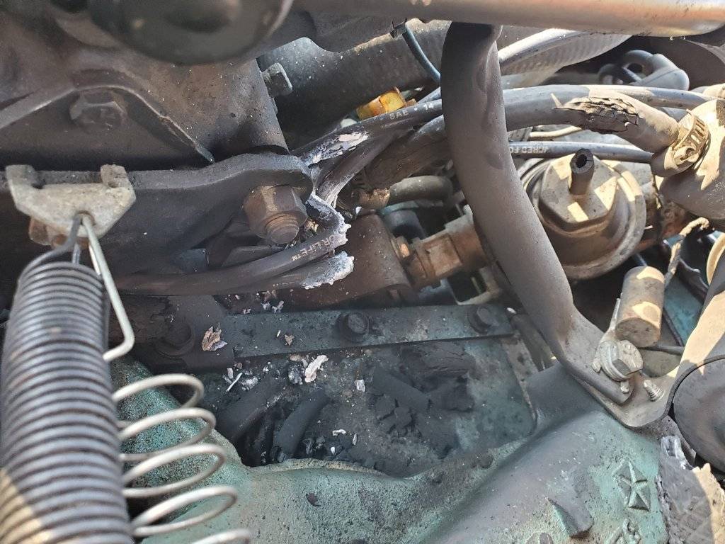

Had a bit of a scare this afternoon. I took my steel lady out for a cruise and when I returned home, I saw smoke coming through the grill and thought, "That's odd!"
I opened the hood and had a small fire under the air cleaner in front of the carb. Luckily, the FD is literally up the road and they were here in two minutes, and were able to put it out in short order. It wasn't a huge fire, but enough to be scary. Turned out a fuel hose developed a leak and sprayed gas on the intake.
I'm thinking new coil, probably a few new plug wires (and these probably had less than 100 miles on them from a recent tune up), carb gasket, maybe intake manifold gasket, of course new fuel hoses and hopefully the carb itself is okay. And I think my insurance covers it. Just may take awhile to get it fixed.
What else should I look out for / tell the adjuster? I'm not sure they're all classic car experts. I don't want to con the guy; that's not me; but I don't want to get screwed either.
