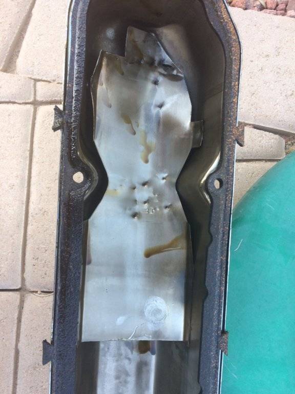

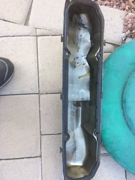

Problem discovered! Listened to the lifters through the valve covers using an iron bar. The noise was coming from the lifter(s) on the right bank (drivers side). I pulled the valve covers and discovered the back lifters were hitting a shield inside the valve cover which was bent. New one on me. Shield is still attached to the cover inside but dented up and numerous marks on were lifter was hitting valve cover. Shield is to protect oil from hose for breather hose. The valve cover has been on the car for 25 years (aside from lifter replacement several years ago) so it is very puzzling? Put valve cover back on and noise resumed. Strange? Ideas?
See pictures
