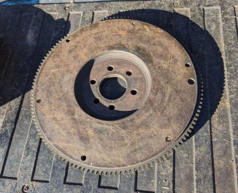

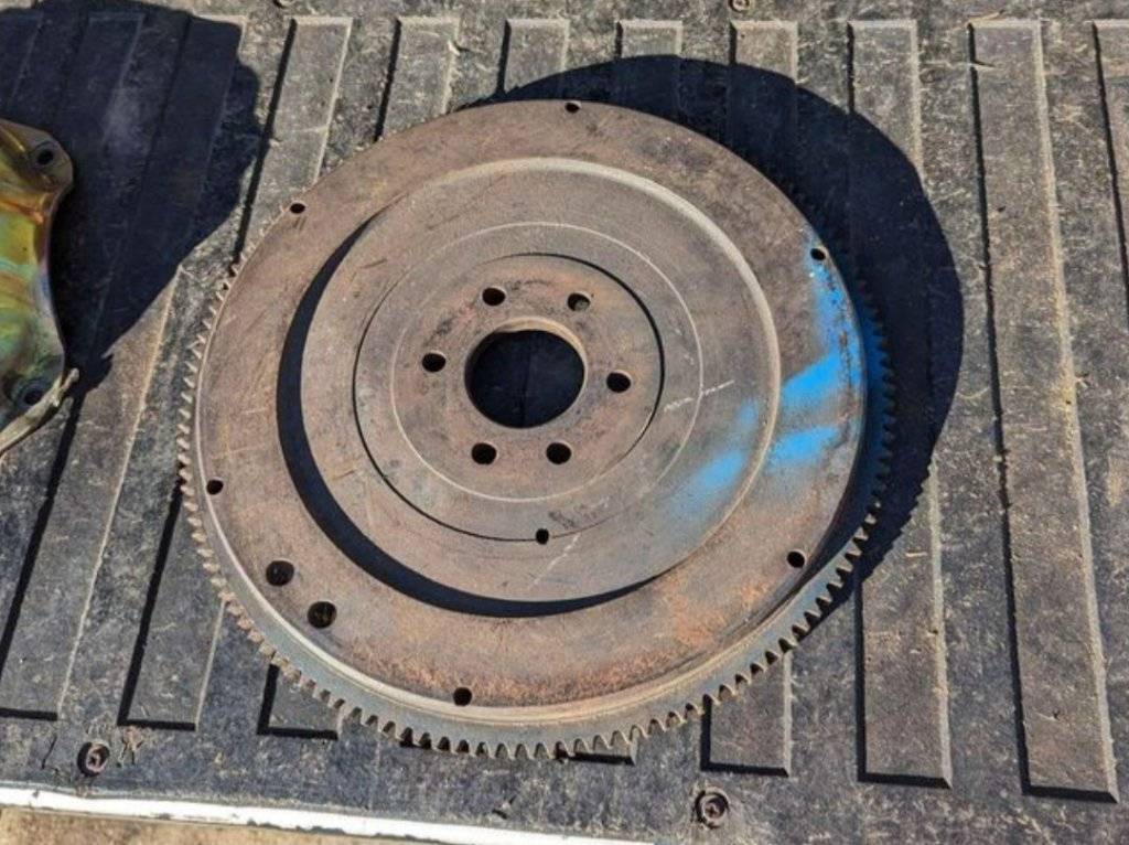

Would this one work? It's said to be from a small block
Thanks
