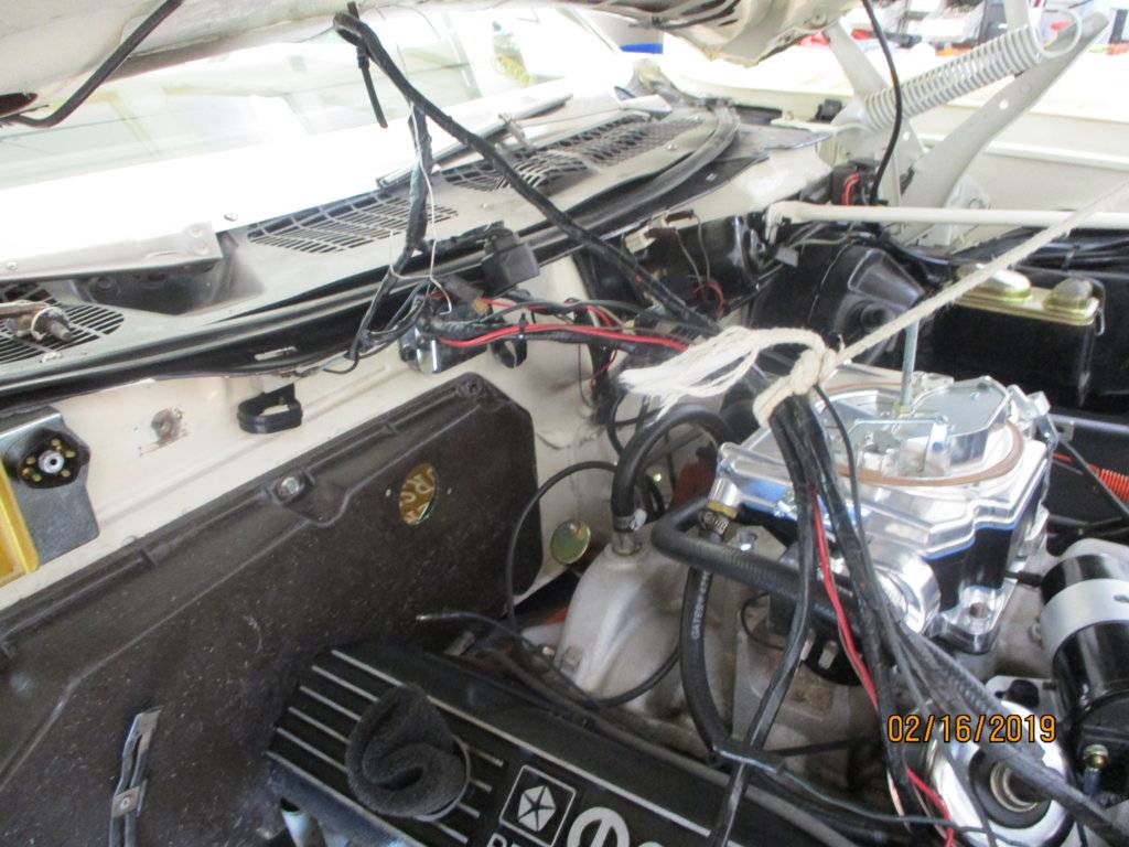

I did check for binding, which is why I'm leaving it on Recir forever. The Fresh pot works perfectly all the way thru its travel and holds vacuum, but the Recirc (forward) pot doesn't pull from the full Fresh position (but does pull just fine once started about 30 degrees of movement) and does not hold vacuum but for about a second or two. So......it's full Recirc for me, and that new foamy sure does seal up nicely against the great outdoors.
I have the blower motor hose, it's in good condition.
