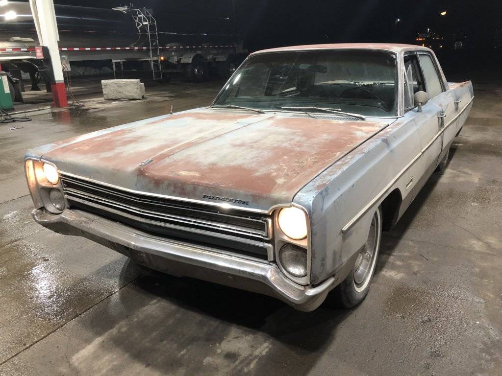

I am planning to procure and install a new exhaust in 'Elwood', my 1968 Fury II Sedan.
The existing exhaust is falling apart.
I have gleaned from this forum (thank you all) that I need a Sanderson DD7-P header set, remflex gaskets (header to cylinder head and collector gaskets), a complete exhaust system from TTI. What I am missing is how to connect the headers to the exhaust and what the best way to hang the system.
Any advise on where to peruse for these remaining items...

Off topic, I prefer exhaust manifolds vs. headers and your car looks exactly like mine did before it got painted. Same color. I just need to get mine put back together.
