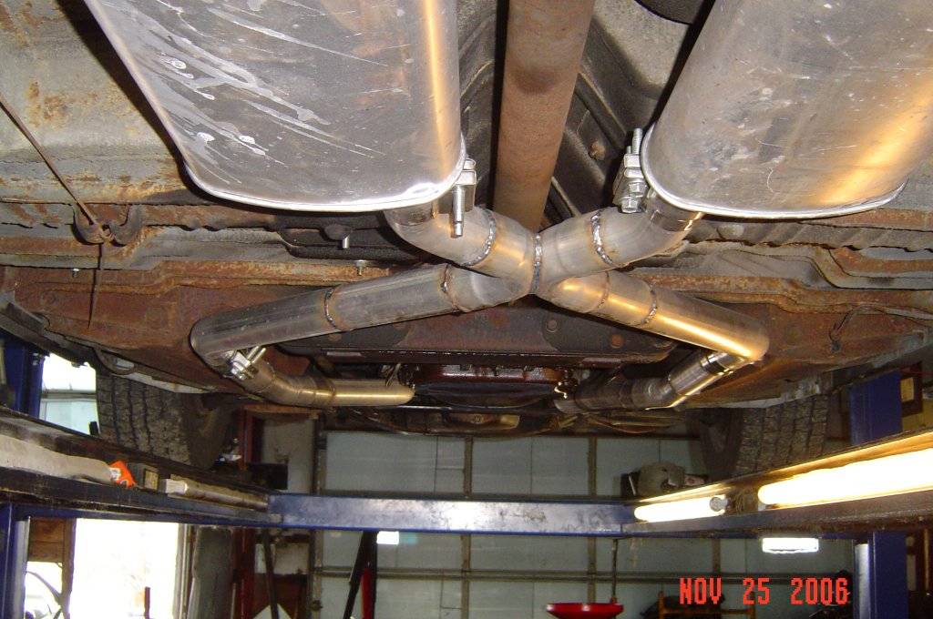

#1 was Summit X-pipe with TTI tails.
#2 was Summit X-pipe with Flowmaster 2.5" B-body tails.
#3 was TTI H-pipe and Flowmaster 2.5" B-body tails.
#1 thru 3 were all 2.5" throughout.
Those were all mandrel-bent except the X-pipe setups required 2 15deg crinkle-bends outboard of the trans.
#4-5 (the Lincolns) were done with Summit Mustang GT cat-back kits and 2-1/4" home-fabbed tailpipes (from individual bends).
#6 (the Diplomat) was 2-1/4" Summit X-pipe and individual bends for the tailpipes. They dumped under the quarterpanel ala 66-67 Chevelle.
I used a Summit X-pipe kit (2 of them, to get some extra long-bends) and TTI tailpipes.
A-B-E-body kits are narrower, as the exhaust cutouts are symmetrical about the driveshaft, while the C-body is symmetrical to the width of the car.
So those would be easier to fab at home.
The Summit kit isn't long enough to fit the crossmember cutout on the driverside, so some extensions are needed.
But - you're fabbing most everything under the floorpan - so what's 1 more splice?
The headpipes actually turned out to be very easy, the correct angle-cut on them got them shooting rearward, and I got both cuts with little fuss.
The TTI tailpipes didn't fit very well. Folks rave about them, I didn't have good luck.
The Flowmaster B-body pipes were much better, and are what I would use on any future C-body.
