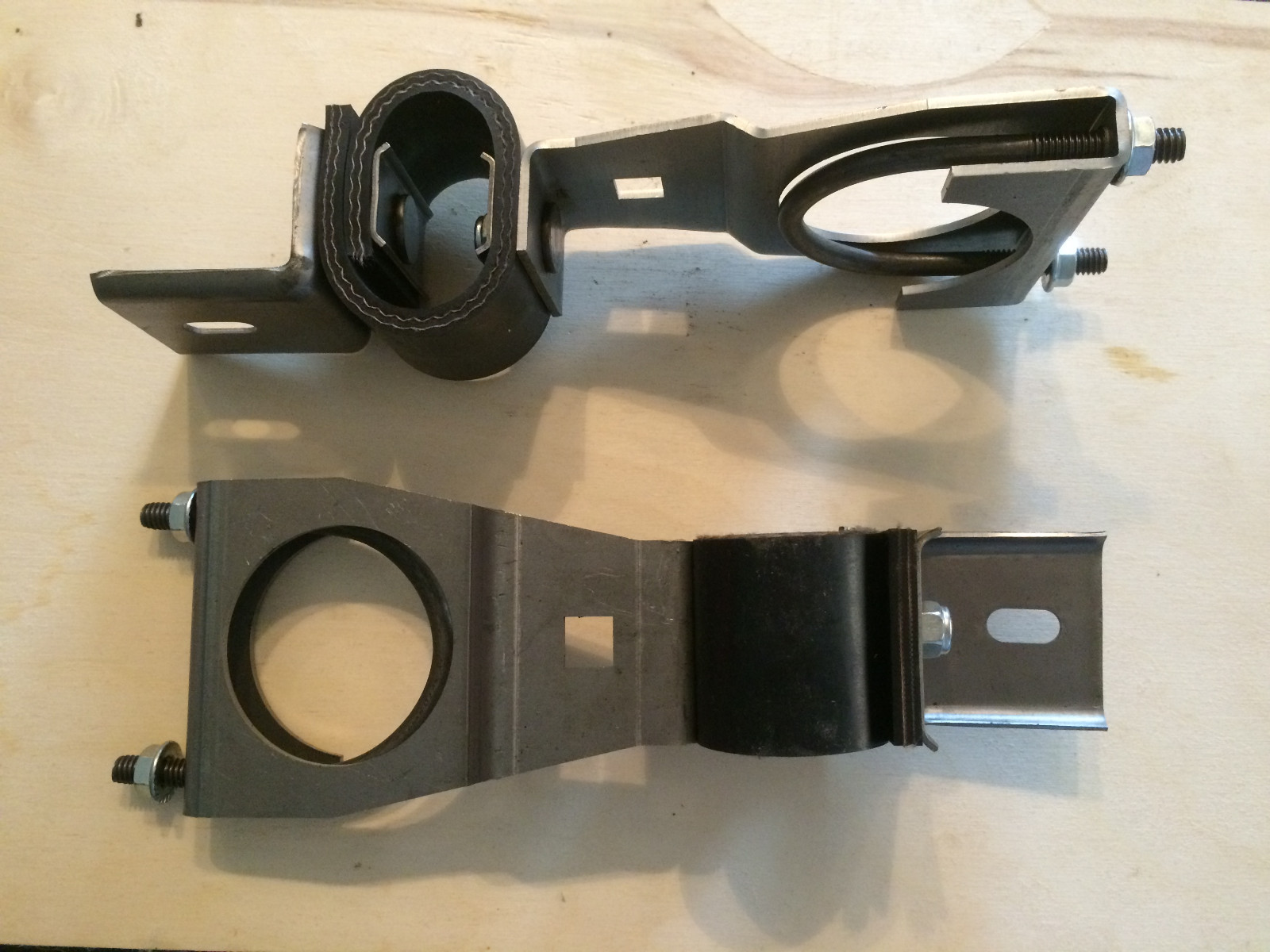

These will work if you are willing to do some fabrication to mount it to the frame.
http://www.ebay.com/itm/1967-1970-r...ash=item541bbfbb1a:g:WRwAAOSwcu5UP-dR&vxp=mtr
If you decide to adapt B-body hangers, make sure your tail pipe O.D. matches the hanger clamp I.D.
Use of those hangers will require modification of the stock tailpipes themselves..... but a much easier mod than hacking up some universal brackets and hangers = basically have a couple of hanger rods welded to the pipes - and off you go !! Even better = replace the ratty tail pipes with a new set of TTI's!!
