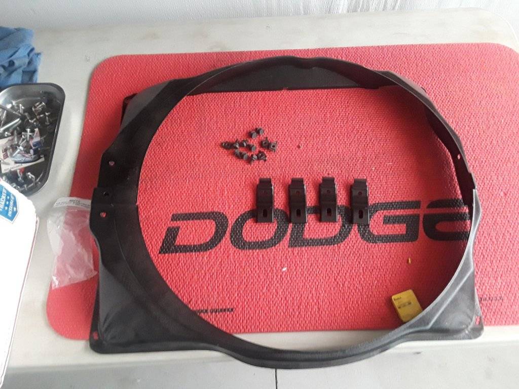

i have what I think is a shroud for a 65 22” radiator. I also have a mounting kit for the same.
“We have a problem Huston”
For the life of me I can’t figure out how to mount this to the rad. I’m thinking it’s the wrong shroud.

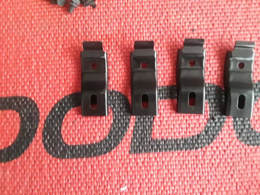

I have two 65-66 22" C body specific rad shrouds and they are different from B body ones, and additionally, those brackets you have are most definitely NOT correct.
Both the correct C body shroud and brackets are hard to find... be sure they're correct as they won't allign to the fan properly otherwise.
Somewhere at home I may have some rad shroud images, but you need to give me some time.
The shroud 'appears' correct from that one image, but the mounts are not. You may be able to contrive something but it won't be a factory original configuration.
Looks like the correct shroud to me. But just know that if your radiator doesn't have the cage nuts in it already, the "straps" will have to be removed from the radiator and put back with them in place. That's what I'm about to go through. No big deal. Any competent radiator shop can do it.

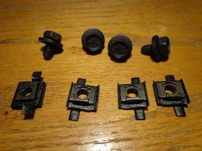

Just be careful poking ANYTHING too far into those slots - the rad core is right there and you don't want to poke a hole in any of the tubes. The bolts are very short for that reason - so they don't poke into the core (see the pic).

I have the inserts and bolts. Apparently I’m short of the brackets
You can machine an adapter bracket matching the current setup, but be careful how you place your shroud. That WAS my plan before getting my new Cold Case radiator. I might knock up a sheet metal shroud from flashing and aluminum sheet next spring, but my pusher fan renders the need pretty superfluous.
TT a buddy today that may have a complete shroud with the brackets. He’ll let me borrow it to mock up brackets. I may go ahead and make some extras for members needing them
