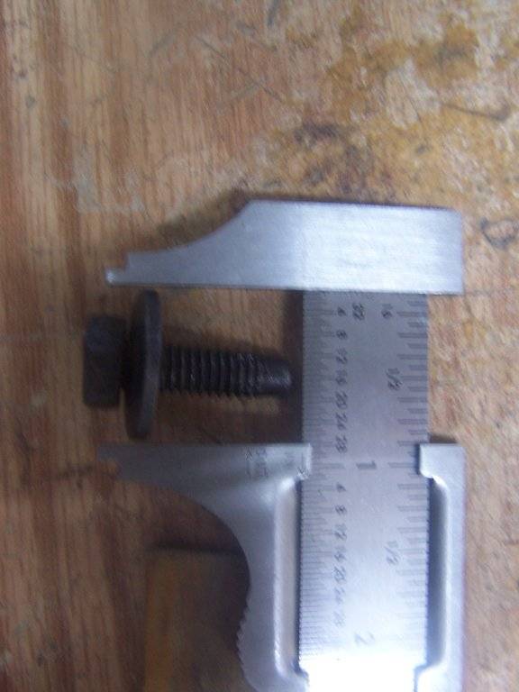

Nightmare continues! Still trying to reassemble my 1965 Sport Fury which I was forced to move from one restoration shop to another story of which I have commented herein before. Never found all the parts and never will and it has been frustrating, at best, to find replacement parts.
I am trying to find a source for the Fender Bolts which are 1/4-20 3/4 inch long with a 1 1/8" washer, black finish. The 1" washers might work if push comes to shove.
Searched the internet and have been to several stores specializing in fasteners; no cigar.
Does anyone know where these can be sourced. Thanks.

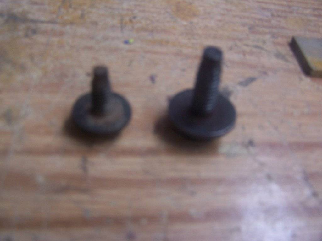

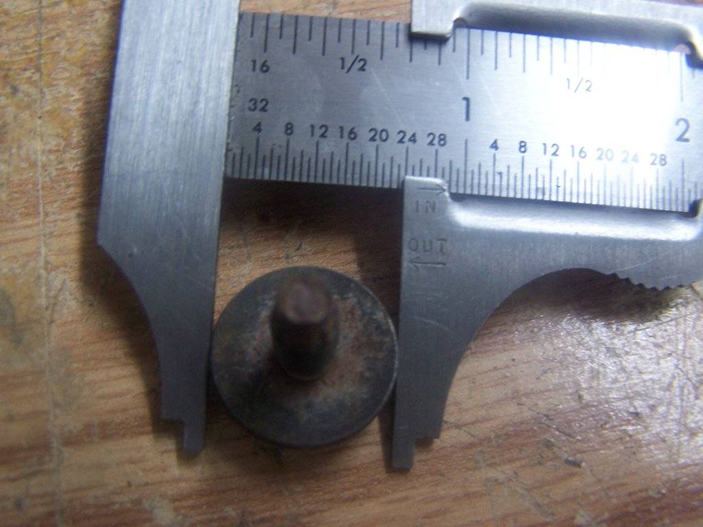

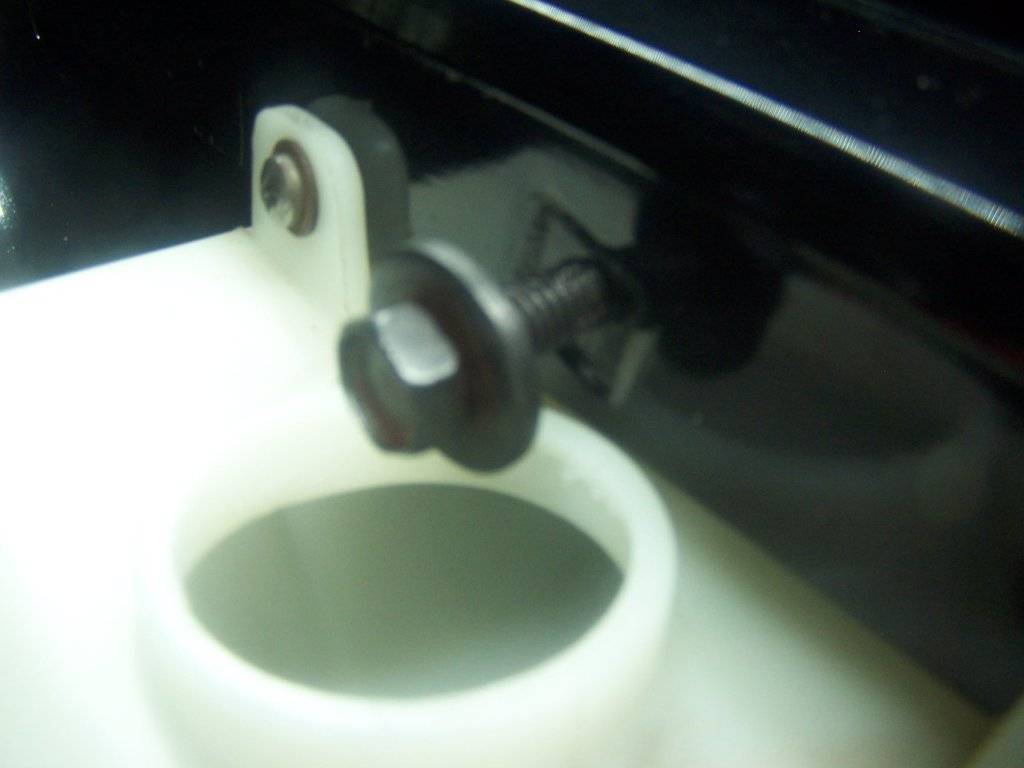

I restored my 65 SF back in the 80's. I used all of the original bolts. The upper bolts along the hood are 5/16" X 1" with a 7/8" Washer as are the core support bolts.
The 1/4" X 3/4" with 3/4" washer are used to bolt the inner fender and go in from underneath. The nuts are all captured nuts so IMO they should all be one size or the other. I believe those two sizes are all that is needed. The captured nut shown in pic #2 is the unused 5/16" one above the washer bottle. I screwed it in for reference.
