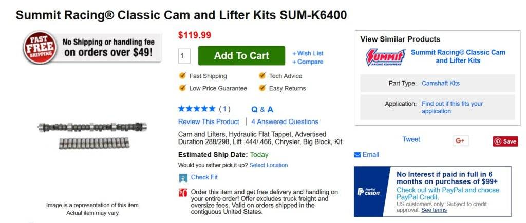

I concur, the 440/375 cam would work nicely. The closed chamber heads are fine, as the later orientations went more to mixture turbulence than the perceived better breaching of the open chamber heads. Adding the 1.74 exhaust valves to your existing heads, plus some bronze helicoil valve guides will put them close enough to 906s, I suspect. Why not start with some used 906s? With a main difference being the larger exhaust valves, IF you also want to put hard seats in the heads, pretty much the same place when you're done if you upgrade your existing heads. Plus, you'll have to pay for the 906s. Clean up the casting flash in your existing heads, port match the intake, and you're done. The ONE real, verifiable benefit of the 906s, with your engine, would be to lower the compression ratio so that normally-available fuels can be used without really needing the more expensive super unleaded fuels.
Of course, matching valve springs will be necessary. With the heads off, that's the best time to do it. As the lift of the cam is should be within the range of a stock HP cam for your model year, you might can delay this. Might do pretty well anyway, but the existing springs will need some checking, so might as well replace them as you'll have to remove the old ones anyway, to do the checks.
To me, ONE reason to use a stock-based cam is the lobe separation of about 114 degrees. This ensures a nice idle with plenty of manifold vacuum at idle. When I put in a cam with 110 degrees LSA, I had to redo the distributor advance curve just to get it to run as expected. Had to play with the idle speed/mixture to get it to idle decently in gear with the a/c on, too. NOT
plug-n-play as expected. Took a bit more to make it work, which was unexpected. Comp is a good brand that's been around for a good while, but some claim they don't use Chrysler-size lobes, but adapted Chevy-style lobes, if that matters (at least that's what Hughes Cams claim).
