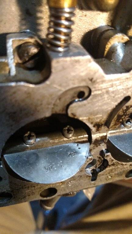

At this point, I have done as much to the carburetor as I can do. If I idle down, ammeter hits the lower notch on discharge.
Here is a photo of the throttle valves. You can see the bend in one. I filed it and reset them. This is why they wouldn't close when letting off the gas.
