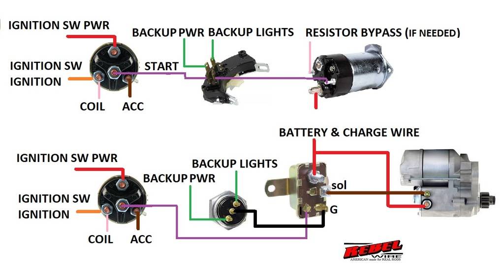

From what I understand the later ness (3wire )will work.Two terminals act as a switch for back up lights and one is for starting.A test with a test light after installation should find the terminal you need.Anyone please correct me if I am mistaken
Yes you can use the 3 terminal set-up and just run a single connector to the Neutral Safety portion of it....usually the center prong I believe.
I believe you are correct.
Joe needs to get the 3 terminal switch and pigtail and wire it up. Problem solved.
This should help

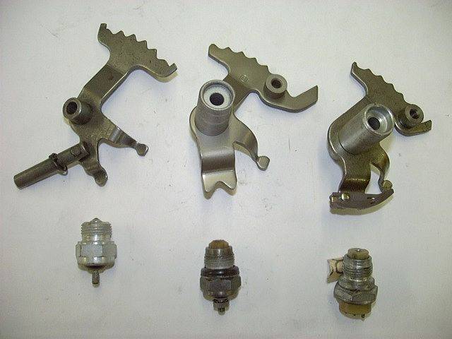

They changed the switches in 1969 along with the "rooster comb" on the transmission valve body. It's my understanding that you can use a single pole switch in a '69 and up trans, but the three pole won't work on a pre '69 trans without swapping the rooster comb. That would involve dropping the pan and valve body. Easier/cheaper/better to find the right part.
'69 up on right, 66-68 in center.

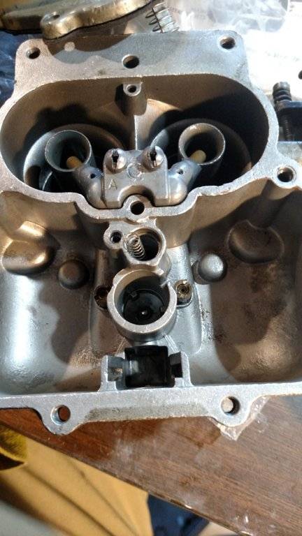

Pulled carburetor today. I have been driving it to work. Stalls sometimes. Bogs. Carb was clean when I pulled it(see photo).
Float level was 7/16. Set it for 5/16. Throttle body butterflies were off. Straightened them out.
Runs 100% better now. Surge and bog are gone.
