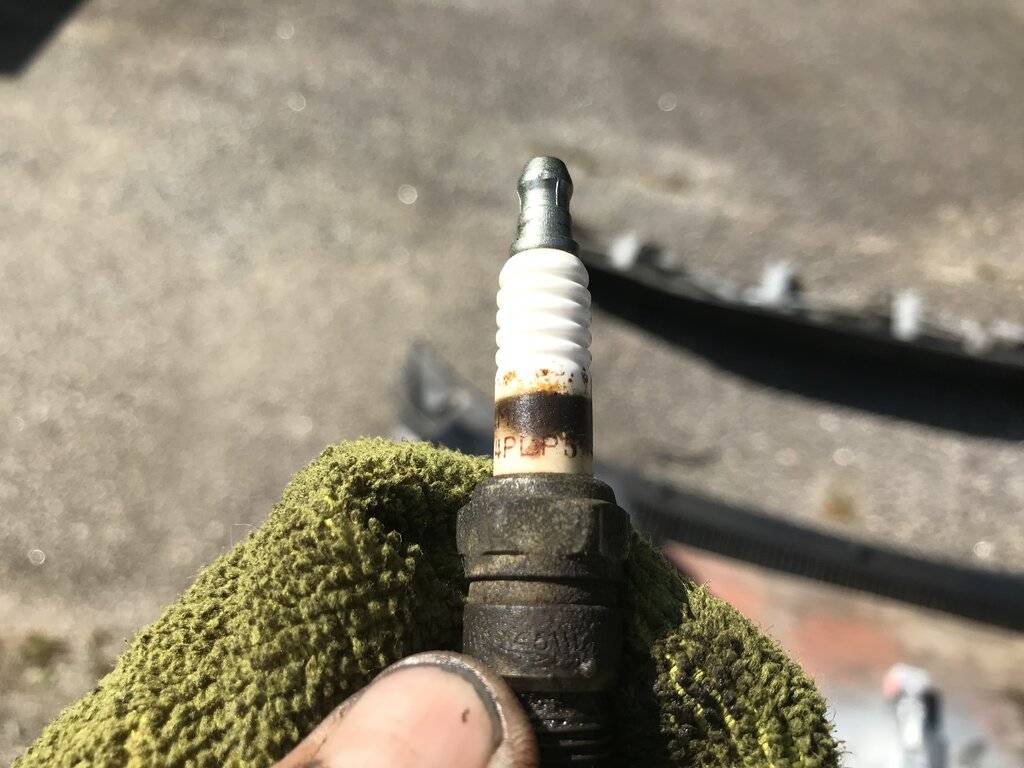

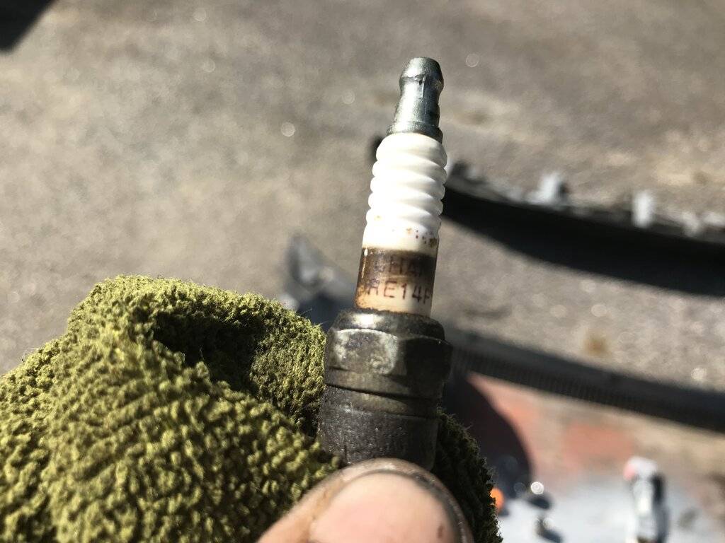

I had already thrown the first three away. Today I changed out the back three. Long # wraps around plug. Looks like RE14PLP5 Here’s two pics

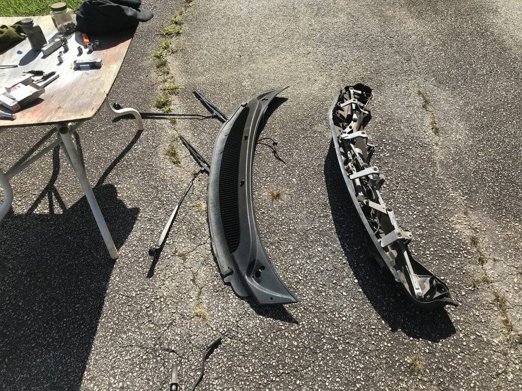

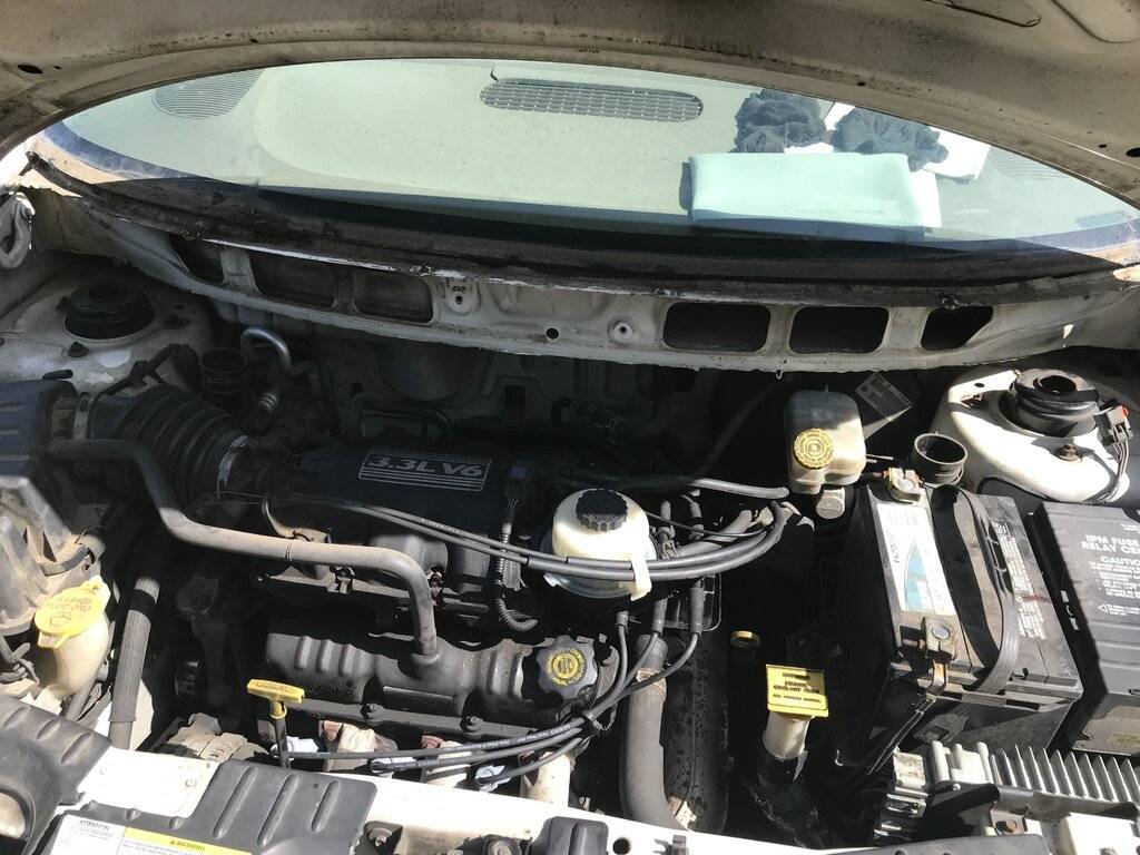

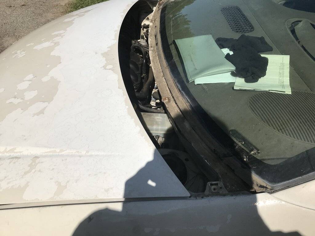

Changed out the back 3 today. Had to take the cowl cover off, wiper arms & the cowl. Not bad at all. 20 minutes & it was off. Help from a YouTube video that was good & showed what tools needed. That’s the best way to do it. Another 30 minutes & plugs changed with new wires. Started it up & idles good. A couple drive way blast & it seems fine. To busy for a road trip. Maybe tomorrow.

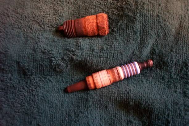

This plug blew out of a Ford Exploder that I used to have. My oldest son had it at the time. He called and said, "It's running a bit rough, but the noise it making is very strange." Of course, that noise was the open plug hole.
Judging by the other plugs, the gaps were all over the place and obviously hadn't been changed in years. It amazed me that it ran as well as it did.
