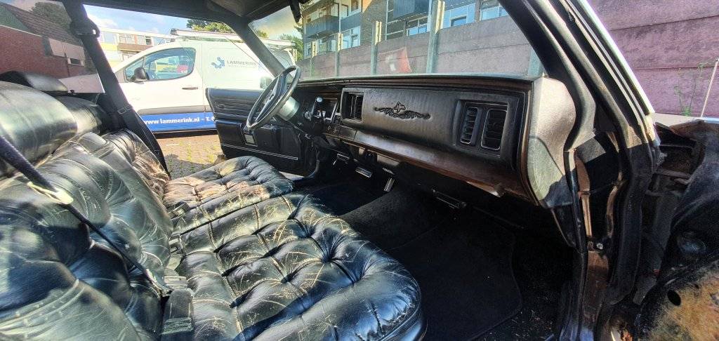

These? If so, what measurements do you need?
Around 145 cm which is roughly 57 inches. The widest point is part of the cushion, I'd say widest part of the frame is maybe 0.75in less.
