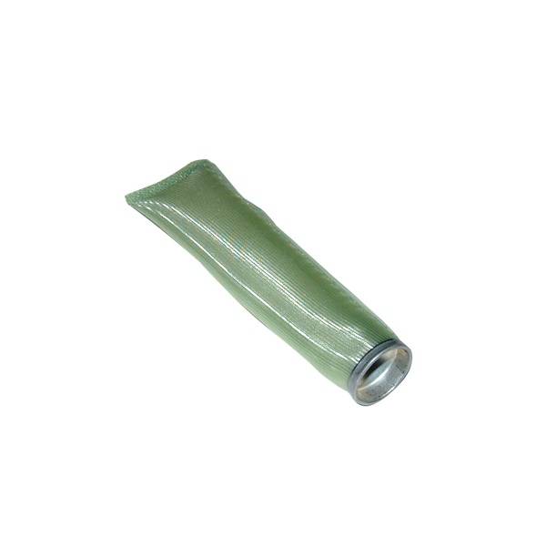

Can just a sock be purchased for the fuel pickup??
The sock is available from Year One (same as B body). The aftermarket senders are mostly junk as far as accuracy goes. You can use a 67 tank and I also think you could use the B body tank. It's just smaller, but it would definitely fit.
Wow, thank you. I'll get on year one today to order it up. Tank is not that bad to need replacing at this point, but need the sock for sure.

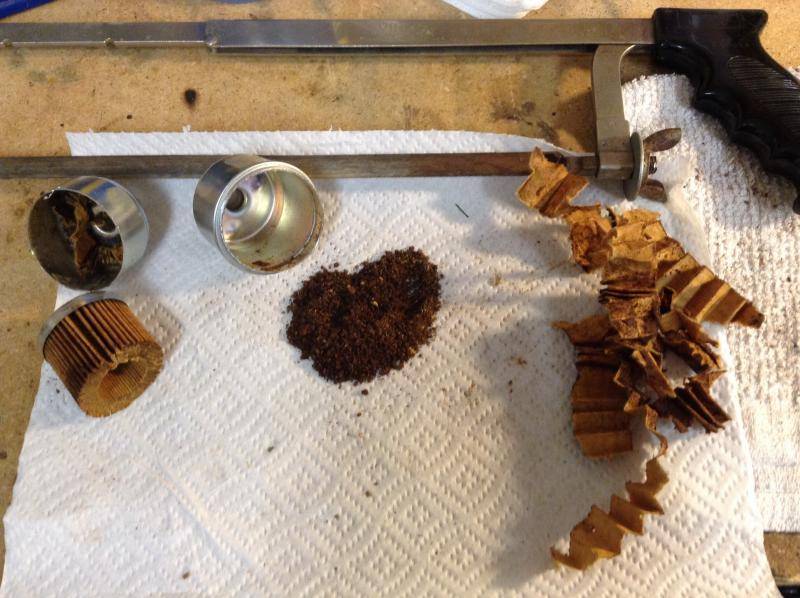

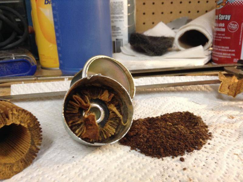

Holy crap!! Not good. I removed the sender as you guys know. I left the rear fuel filter on the line. Just for my own curiosity I cut the rear fuel filter in half to see what was inside! I replaced these filters only about 25 miles ago. You think the tank is dirty??!! This is just what was inside the rear fuel filter. Look at the size of the pile from one filter!!!! I will remove the front filter tonight and cut that one in half also. I'm hoping that the rear filter caught all the debris from the tank and the front filter is clean. If not I'm going to have to take the new 850 apart. This could have been avoided if the sock was on the sender, but then again, I would have had no idea that the tank was filled with ****. See pic.
I guess this can be expected from a 46 year old car....
Three letters: Oh Em Eff Gee.
Ok. That's four...
I hear that. LMAO, you're too funny man! I said more than four letters!..lol

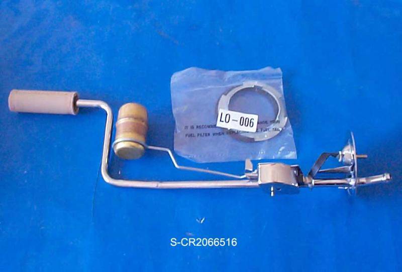

I found this on Classic Car Auto parts site. With shipping $92. Dammit!!
Whats your opinion on just installing the old one with a new sock? It did work.
Whats your opinion on just install the old one
I think it will be 50/50 no matter which way you go. Murphy's law after all...
Find in the FSM how to test them on the bench.
Already tested it and it's fine. Gas gauge works. Now I need to order the sock or it might be in the tank still. Have to look.
