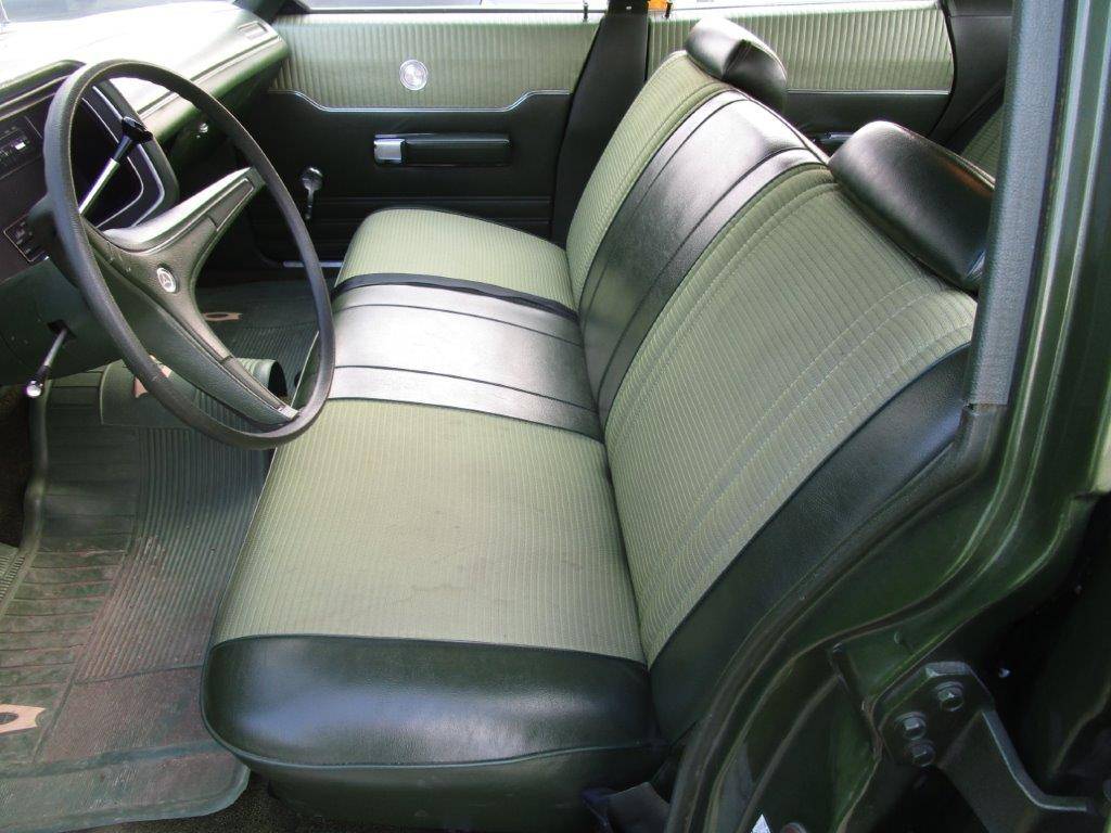

My '72 Polara 4-dr. front bench seat bottom needs some additional support. I feel like I'm sitting in the seat instead of on the seat. The car has 19k miles, which I believe is original based on the condition and history. The interior is in excellent original condition also.
1) Can the seat be made firmer without removing the seat cover?
2) If necessary, can the seat back be separated from the seat bottom?
3) I have a '72 Dodge Body Service Manual.
4) I looked at the underside of the seat and didn't see any obvious issues with the springs, etc.
5) I'll try contacting a local upholstery shop for possible fixes.

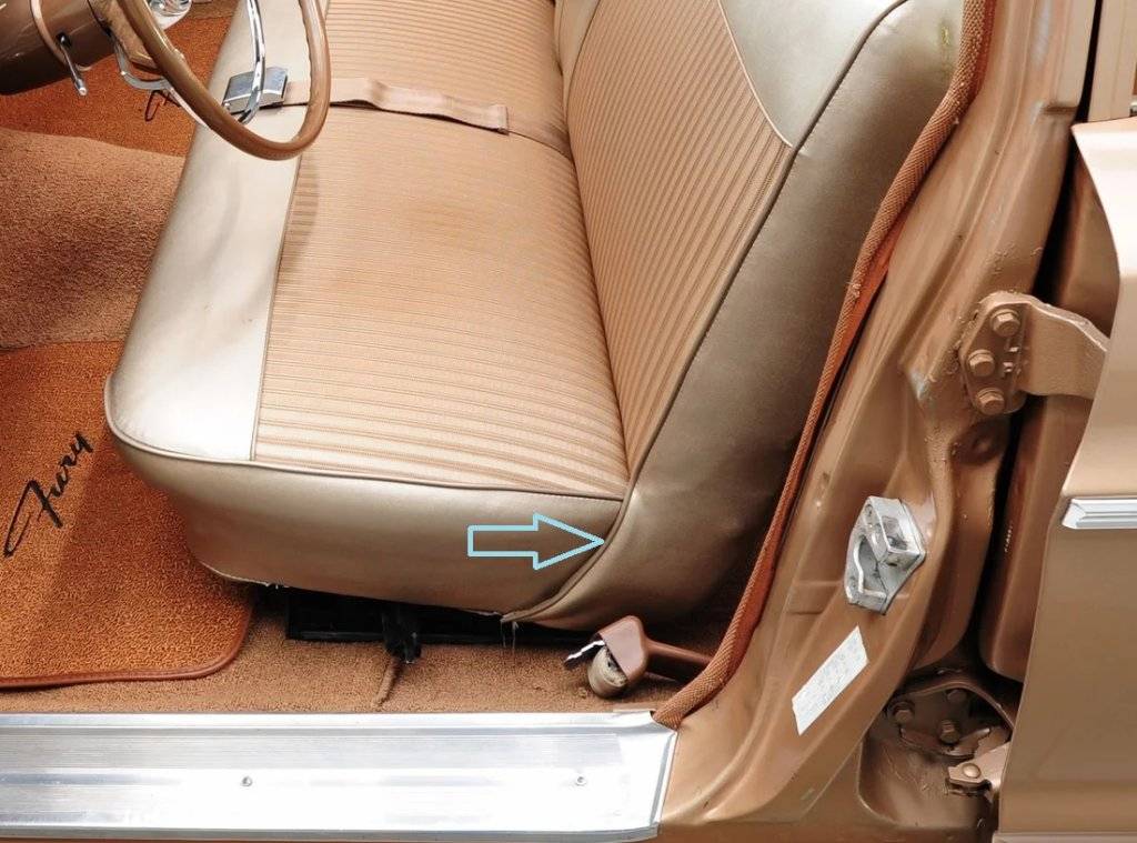

You said the seat back can be separated from the seat bottom. I didn't see anything in the Body Service Manual on how to do it.
Sorry, I missed this.
I haven't had a 4 door seat apart in a 70's car, so I can't give you specifics. The top is just bolted to the bottom though. If it's like earlier car seats, the the flap, shown in this pic with an arrow, is covering the bolts.
IIRC, that flap is fastened with small screws to the seat bottom. It may also be hog ringed to the base.... I honestly don't remember. Just get the flap loose from the base and there should be bolts under the flap. Just feel around that part of the seat before you remove it. The bolts could be in the bottom or the top.
I'm going by memory here, which isn't as reliable as it used to be.. and it's been many years since I had to take apart a 4 door seat.
IF SOMEONE ELSE CAN CONFIRM OR ADD TO THIS, PLEASE DO.
