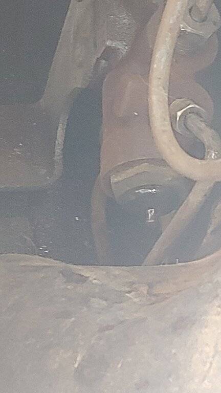

Am I correct to assume that my proportioning valve is not working properly?

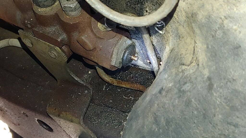

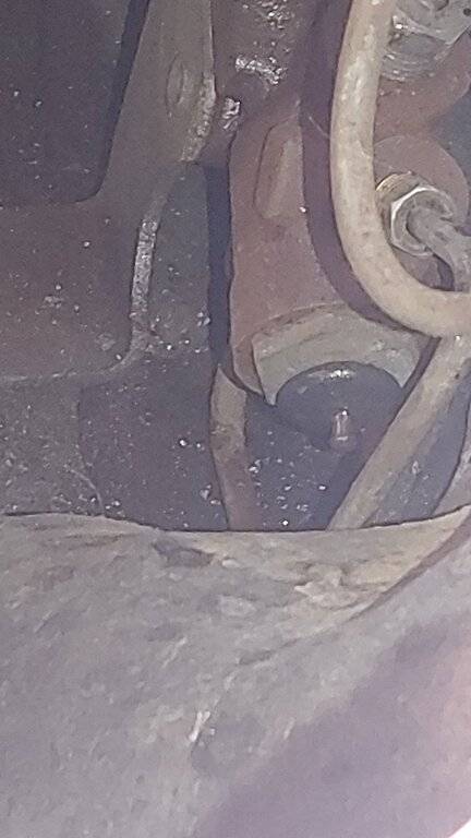

Is the little dick on the front of the prop valve a push in type clearing button? What is that little dick thingy?
Otherwise, suggestions please as to how to proceed on getting the front brakes to work.
That's the centering valve, probably bad, use something to hold it in, then bleed
Ok. thanks. I tried to press it in but it was pretty solid so I didn't push hard enough to break it. Apparently I need to push harder. I'll try that.
Wow. that much pressure.
Am I expecting it to go in 1/8" or more? 1/4"?

So, if I can't get it to push in while on the car, Is it as easy as removing the Proportioning Valve, Then removing the centering valve on the bench, cleaning it, installing the centering valve and reinstalling the proportioning valve?

If you are dripping fluid out of the bottom of the master cylinder, either one of the two brake lines is not properly seated or the master cylinder has bad rubber cups inside and fluid is running out the back of it and dripping from the bottom. If the front brake line is not seated or the front piston is bad, it will suck air every time the pedal is released and the system will not bleed. The centering valve also appears to be leaking given the wetness around the rubber on the front of it. There are o-rings inside of most of them and yours may have failed.

I have been messing with the system and actually caused the wetness on the rubber centering valve.
Try cracking the bleeder screw on one of the rear wheel cylinders. That will release hydraulic lock on the centering valve and it should push back that way. Bleed the fronts and then try bleeding the rears.

Nope, didn't work. Tried cracking both sides.
In that case, do you have a bench bleeding kit, that is the short hoses that go from the two output lines back into the master cylinder fluid pits? If so, disconnect the front line and purge the air from the front brake piston. This should give you enough pressure to force the centering valve back where it belongs so you can complete the bleeding process.

You cracked the rears and the valve wouldn't move?
Try wrapping " carefully" on the side of the valve, when it's being pushed in, should move
I tried tapping it already.

The valve would not push in when either of the rear bleeders were open and dripping.
