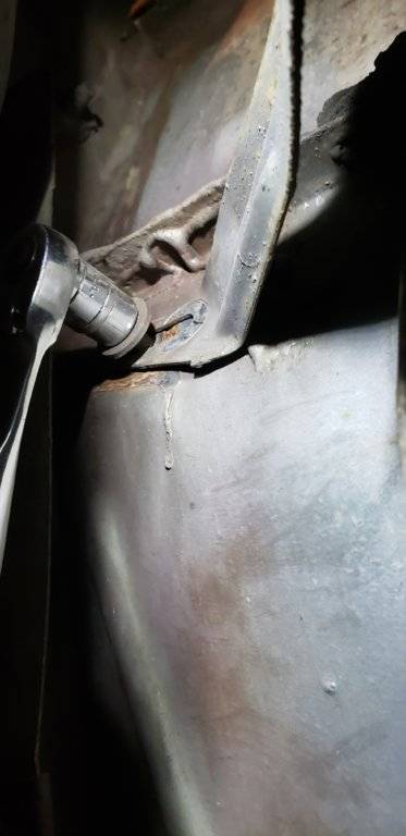

1. There is a hidden bracket on the rear of the fender about half way up the rear wheel opening, that requires you to remove, at least partially, the outer wheelhouse shield. A very small 7/16 socket or gear-wrench will be needed.

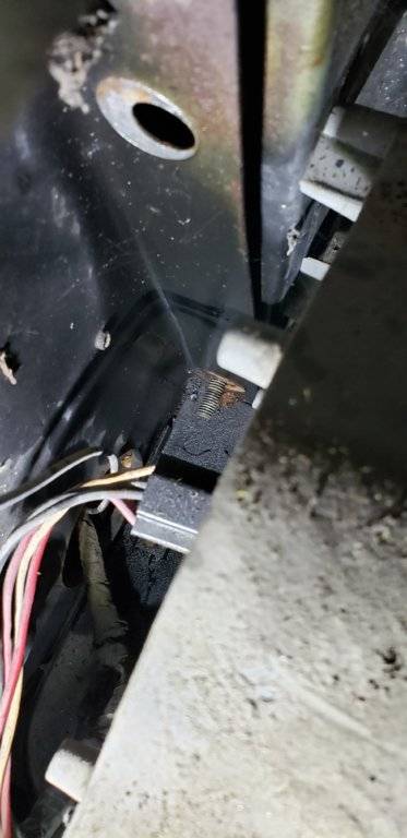

2. There are two diabolically hidden bolts at the bottom front of the fender, right behind the outer part of the bumper. See the picture of them, they are almost braille items.
