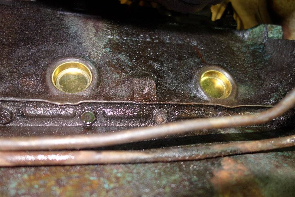

I use brass freeze plugs only. These are 1 5/8 on 318 small block. Sand surface, apply Permatex 2 Form-A-Gasket Sealant, drive new freeze plug into place. Stopped the leaks for 4 years until I replaced the motor.

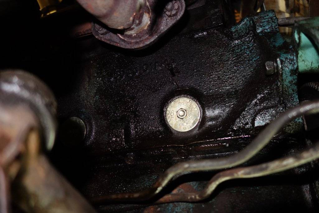

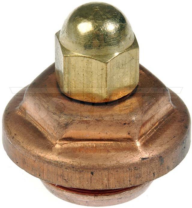

I've never used these, but I know guys use them in boat engine applications with great success. If you can't get to it to hammer it in, this would be the way to go. I would use them.
Dorman product, buy by size and I wouldn't expect the chain parts stores to have them... In fact I couldn't buy even plain expansion plugs at the local O-Really's . No idea what I was even talking about.

Hi John. I used these and the leaks continued. Are the ones you pictured a special type of expansion plug? How tight should they be to get them to seal? Thanks.

You put these in, hold with one wrench and tighten with another. As long as everything is clean, they should work at least as well as a replacement plug, and much better than a rubber one.
The Dorman expansion plugs, on the other hand, are used by some of the marine engine builders for new engines. What I read was they stayed in place better in a boat where the water is brought in from intakes at speed. Like I said, I've never used them, but I've held a couple in my hand and they look robust and well made. I think someone here may have used them with good results.

I only ever used Brass ones. I prefer the deep ones if I have them on hand. Steel ones will rust and need replaced, where brass won't.
