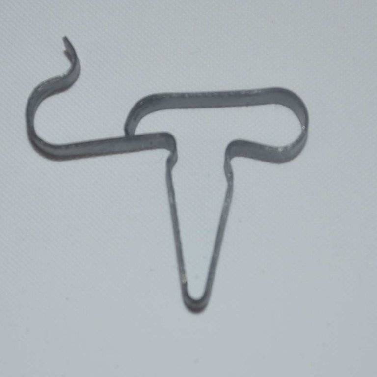

Absolutely no body panels or grill needs to be removed to replace this line. I did it on my 68 NYer just 2 years ago. In the engine compartment where the line comes out of the stub there is a little clamp that holds it to the stub frame. Remove the clamp. Use lots of tape to secure some mechanics wire to the line. Go back to the side of the and remove the line from the frame pulling toward the rear. You'll have to twist some as you go.
When you make you're new line put the kink in it just like the factory had. Tape it to the mechanics wire and pull it up through the frame. Tape the end off good so you don't get an junk from inside the frame in your new line. This shouldn't be a hard job to do. You'll probably need about 6 feet of wire.
