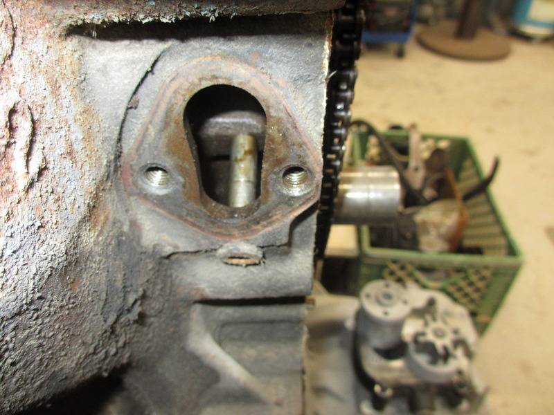

Guys, I bought a replacement fuel pump for the 383 and decided yesterday to install it. What a mother. You can't get a wrench on the bolts, and it's not straight for a socket. Finally removed it and tried to install the new one. The fuel pump rod kept sliding down, I did try grease. I was using jackstands so I had no room. After fiddling with it for hours I finally got it in. I have done some hard things before, but that took the cake. I needed another two arms. Do we work on our cars because we enjoy it? That's my rant. Next is replacing brake lines. With me luck.
There's a plug to remove in the block that will allow you to push/hold the rod up. Just Monday morning q'backing.

I've used the shorty socket and extension with success to remove the bolts. No issues here. 20-30 minute job.

The big problem is not only that shrouded rear bolt, but trying to hold the push rod up with one hand / finger while you try to insert the pump arm under it with the other hand / finger. Its a job an Asian girl can do pretty quickly.

Timing chain was a cake walk compared to to fuel pump. Let me know when you install one with the engine installed. No room.

Been there, done that, finally "ran to Youtube like a little girl" to find the trick with the grease to hold the plunger up. A one beer job that turned into a 6-pack, so it wasn't all bad!
