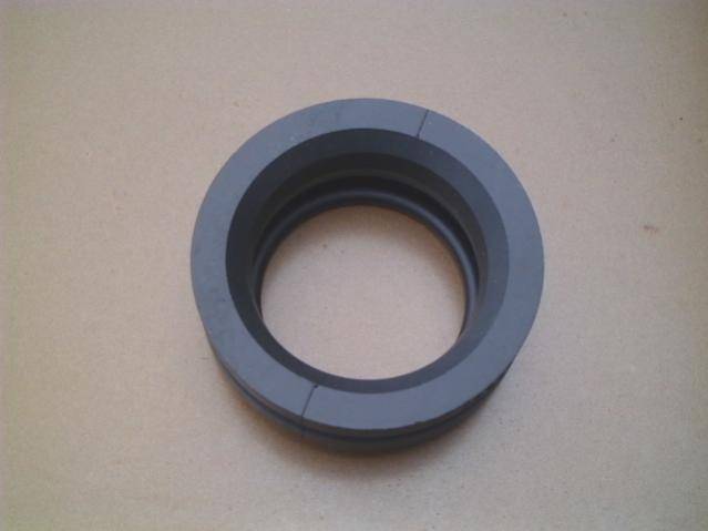

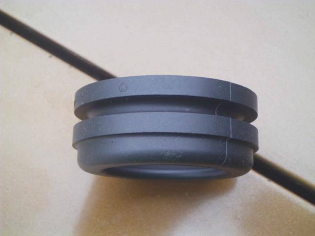

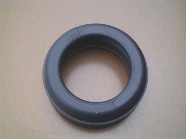

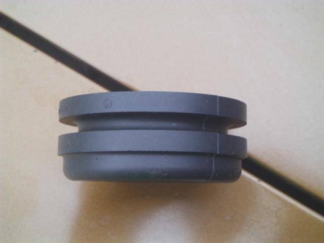

[TD]New replacement gas tank filler neck grommet
  • Fits 1966-1978 C body cars (not station wagons)
  • Replaces the seal from the tank to the filler neck (almost always dried out and leaking) $20.00 shipped each 1
    this is a mopar part not after market

AHHHH yeah. Lookz like ah grommet to me. Somewhat used and ah little abused. Assuming you're looking for a new one try Year One. And we're thinking it iz ah C-body rite? It shouldn't make any difference with that grommet tho' 'cuz E, B, C, bodyz should all be the same. Just make sure you're talking to some one down there that can find their a$$ with both handz at the same time. They been hiring ah few no-nothin's the last couple yearz, Jer

Funny, that looks the exact same as what's in my 66-300, and It's for a 68 Dart, So, what's the point?
Thx for your very helpfull answer... NOT
I think what you fail to realize is that Mopar used a lot of interchange parts between all models of cars. If you can't understand that, then your welcome for the education!

How did I not help you? They're all interchangeable. How is that useless info? Do you think that little rubber washer between your sending unit and gas tank are model specific? If you can't see that, that's your problem, not mine! No fault on my part here, just tryin to help. Good Luck

BTW the grommet part number is 4002010 (the OP’s price shipped is less than list price, so it’s a good deal). I just bought four at the dealer. It is NOT identical to early C and B bodies. I have no knowledge about if it would work on those but I suspect that it would, although it would be obviously wrong if anybody cared to look. It is absolutely correct for formals; it is the original part number.
