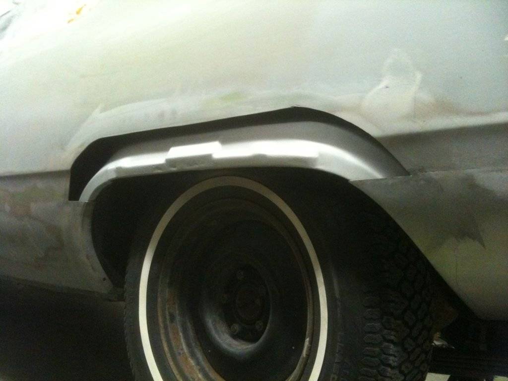

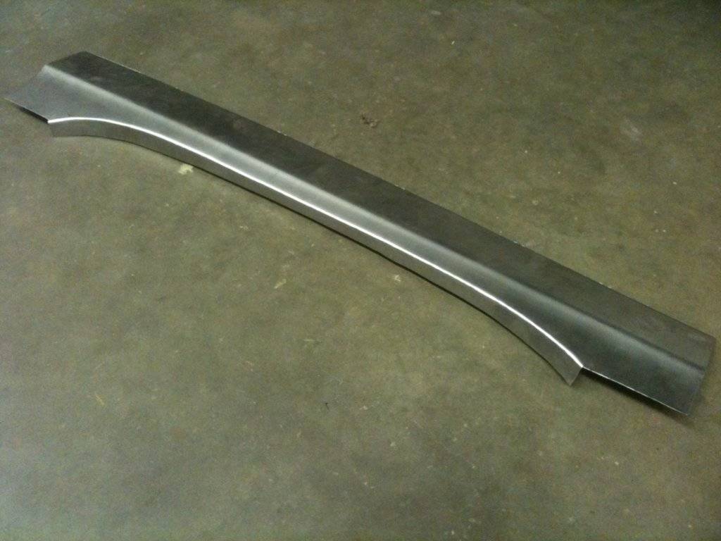

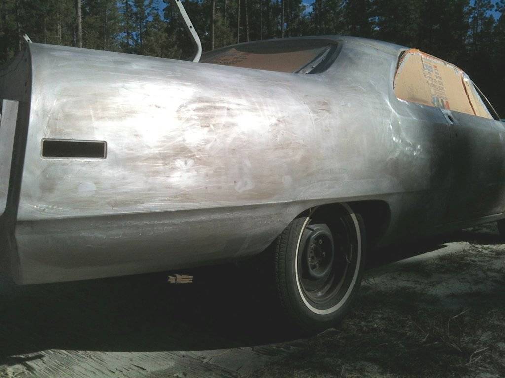

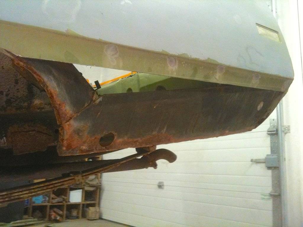

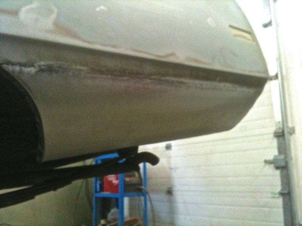

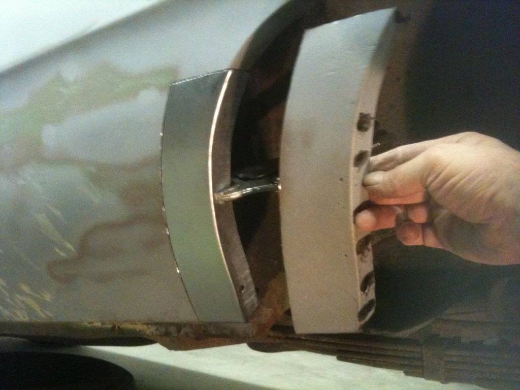

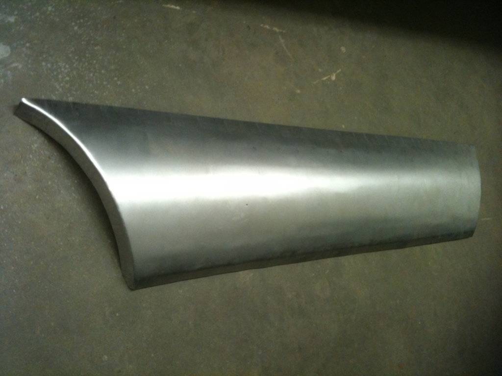

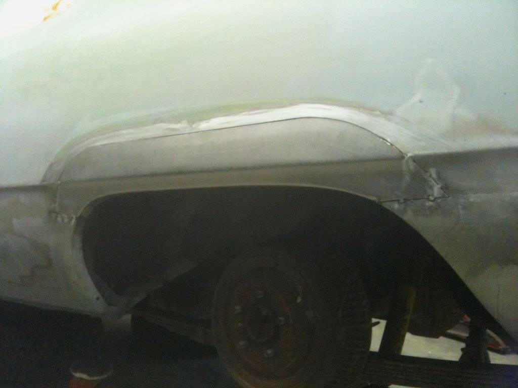

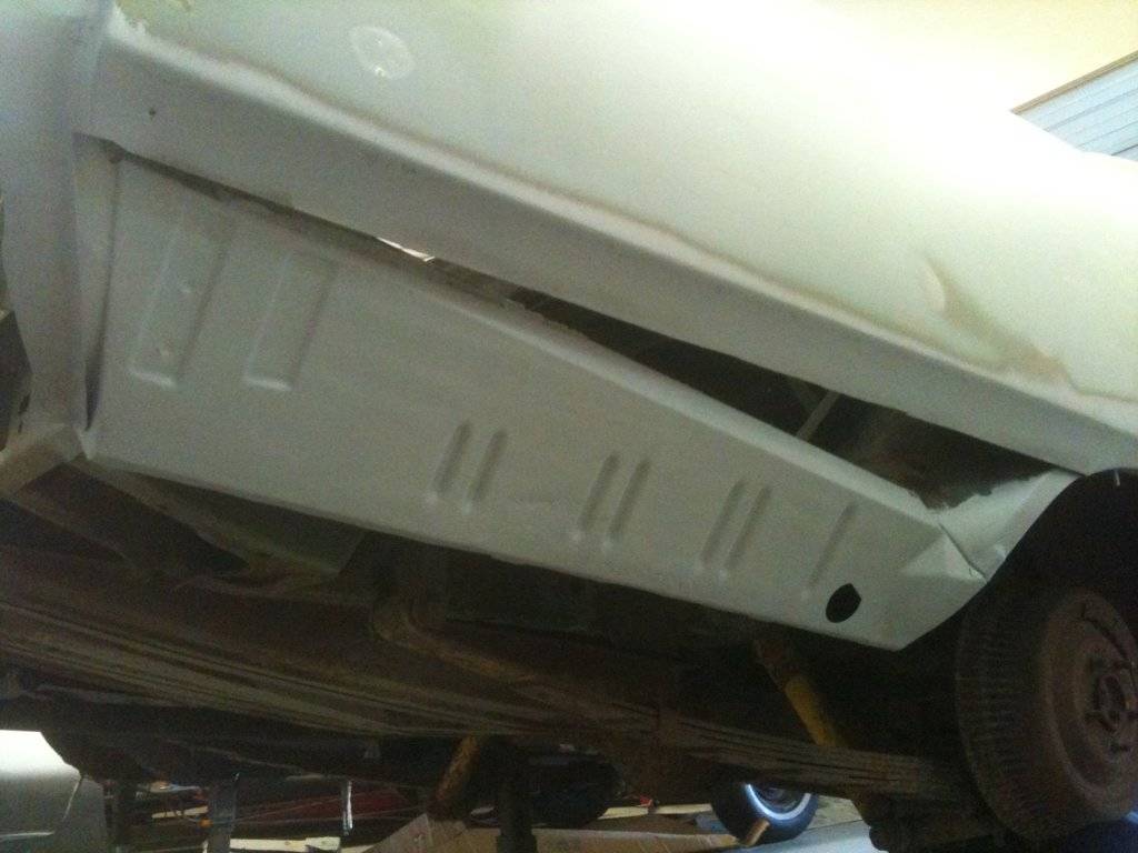

Since there are no quarters or repair panels available for C bodies, I make my own. Inners are blasted clean and sprayed to prevent rust before the new panels are welded in. The new panels were butt welded in place, for a nice flush fit.
FIFYYou really could start a “full-time” business with the quality of your work.
Looks like it would fit a slabside better than a Fuselage.Just perfect!
