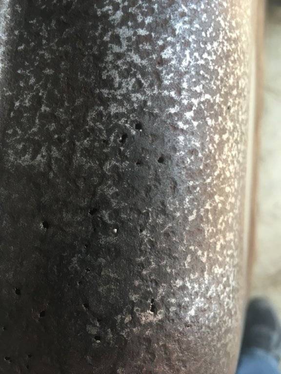

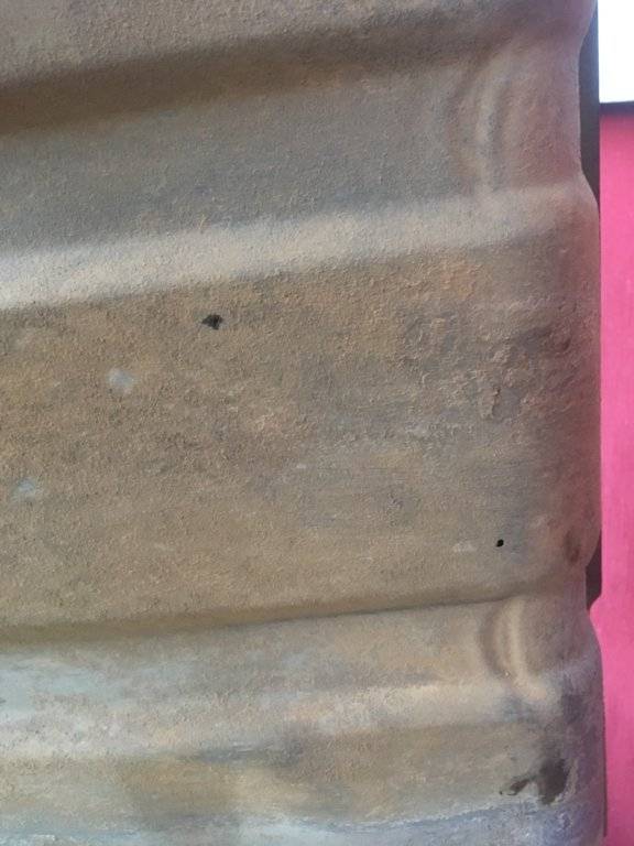

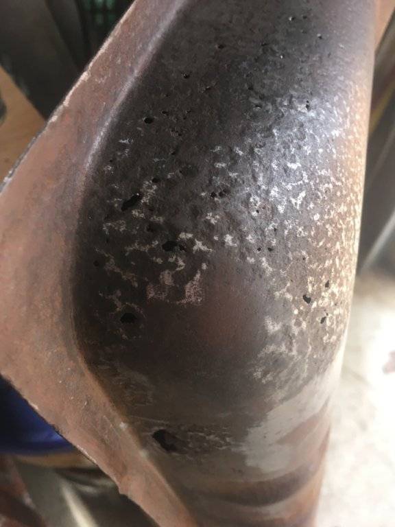

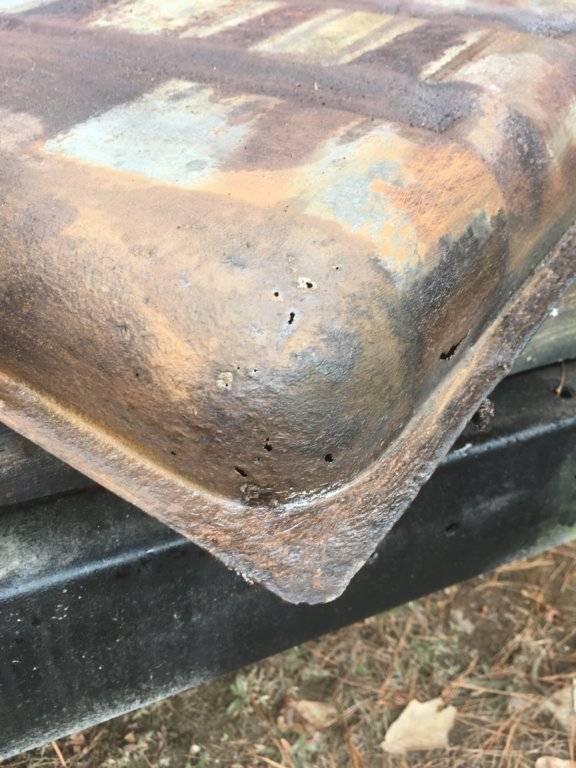

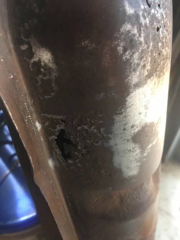

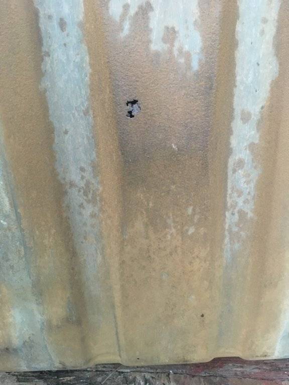

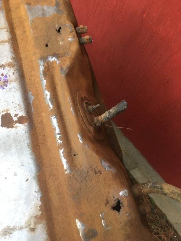

It all depends on your budget. We dropped the tank on my 71 Polara and after draining 5 gallons of 25 year old gas did we discover one corner was rusted out. So instead of buying a new tank, I went onto Facebook and found a guy with a junkyard in NJ who’d sell me a tank he had. Long story short, met him halfway, paid him way more than what I thought we had agreed on (he had a delivery fee too), got home and discovered the tank was worse than what we had. Since the car was no where near road worthy (and won’t be for at least a year), we took some JB Weld putty and filled the holes and painted the tank. Works great for me being able to drive it around the yard

View attachment 280921 View attachment 280922 View attachment 280923 View attachment 280924 View attachment 280925 View attachment 280926 View attachment 280927 It all depends on your budget. We dropped the tank on my 71 Polara and after draining 5 gallons of 25 year old gas did we discover one corner was rusted out. So instead of buying a new tank, I went onto Facebook and found a guy with a junkyard in NJ who’d sell me a tank he had. Long story short, met him halfway, paid him way more than what I thought we had agreed on (he had a delivery fee too), got home and discovered the tank was worse than what we had. Since the car was no where near road worthy (and won’t be for at least a year), we took some JB Weld putty and filled the holes and painted the tank. Works great for me being able to drive it around the yard

I can only look back and laugh about it now. Was an expensive mistake, but I learned from it. The original gas tank had its biggest hole filled with JB Weld and everything got a coat of rustoleum. Been 2 years since and zero issues
