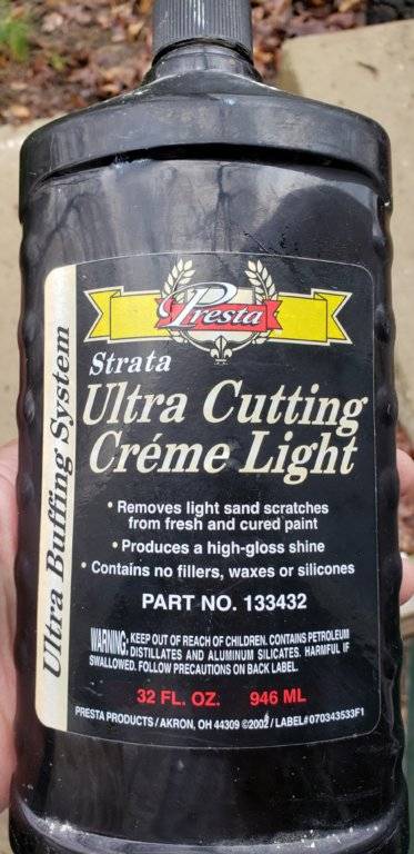

This is the second step compound I have been happy with, after applying the Imperial first, only $25 at Walmart.

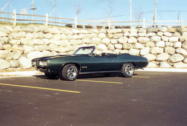

Just for clarification, I would never recommend a guy buff out a new paint job, until they have buffed out several cars. It sounds to me it would be the perfect car to start on. I have never burnt through paint and I am self taught before there were YouTube videos. I have been doing this for probably 25 years.
Here is what Goldie looked like after I buffed out drivers side of the hood. The orginal paint was so oxidized that I couldn't even tell it was metallic paint.

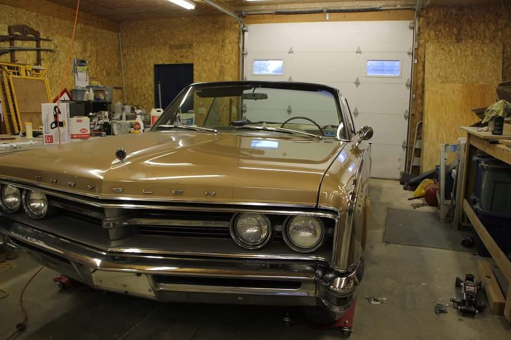

This was a 2-part paint job done about twenty years ago. A year after painting it was wet sanded and polished. The sheet metal was soooo straight on this car the extra work was well worth it. Paint was glass smooth and far better than the factory paint from Baltimore Assy.
