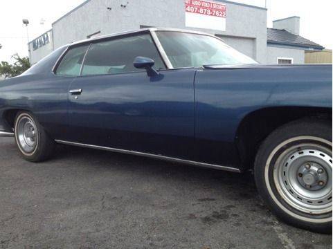

Cruisin the CL ads and came across this pic of a '74 Caprice.
Look at the wheels. Identical to our Road Wheels only with the 4 3/4" GM bolt pattern. Interesting....
The front is missing the trim ring but you can see it on the rear rim.
Noticed this design on some van from the 90s I think, don't remember the make but no Mopar product.
Full size GM cars used a 5 x 5 bolt pattern for a time. I know my '79 Buick Electra had 5 x 5 wheels and also some of the station wagons from that era used them. The car pictured was from the previous generation and I think all of those B and C body GM fullsizers from '71 to '76 used a 5 inch bolt spacing. I don't know about pre-'71 models. In '77 with the downsized B and C bodies, only the C-bodies (Olds 98, Buick Electra, Cadillac) and station wagons had the large bolt pattern wheels. As was said, those are GM light truck wheels.
I would say they would be van wheels, as the only 1/2 ton GM pickup or Blazer wheels that I have ever encountered through the '70s, '80s and '90s were 6 lug...:eusa_think:
OK. 5 inch then. I stand corrected.
So those would fit on an Imp. eh? :weg:
From a bolt circle perspective...it should. As I recall, the GM truck wheels were wider than Mopar offerings (like 8 inch wide?) so there may be trouble with the offset and tires rubbing under fender skirts.
